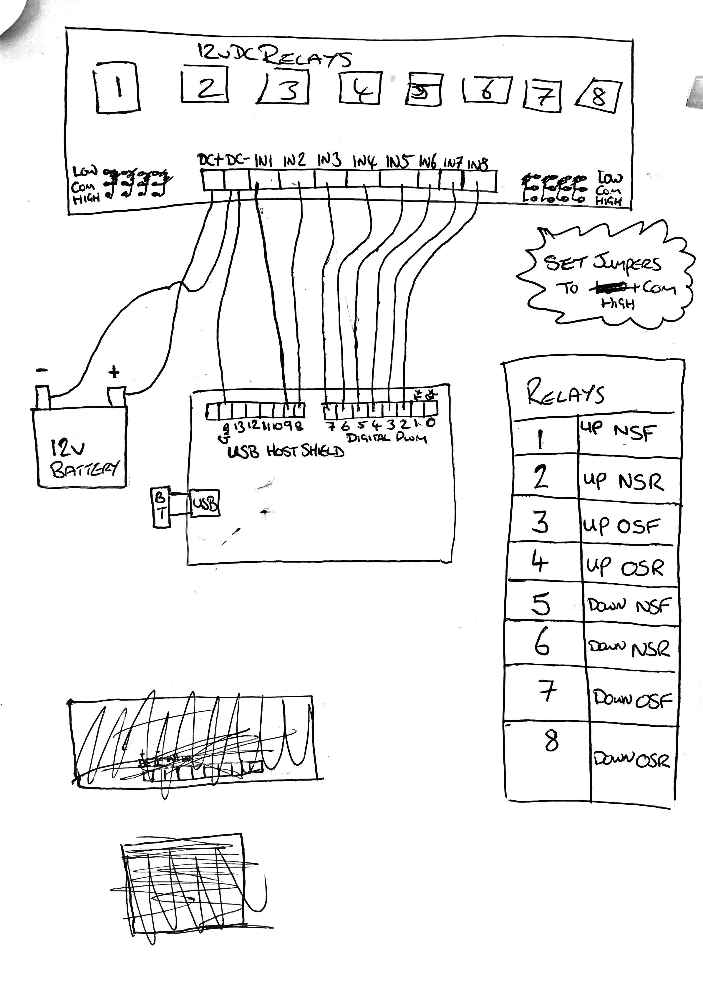

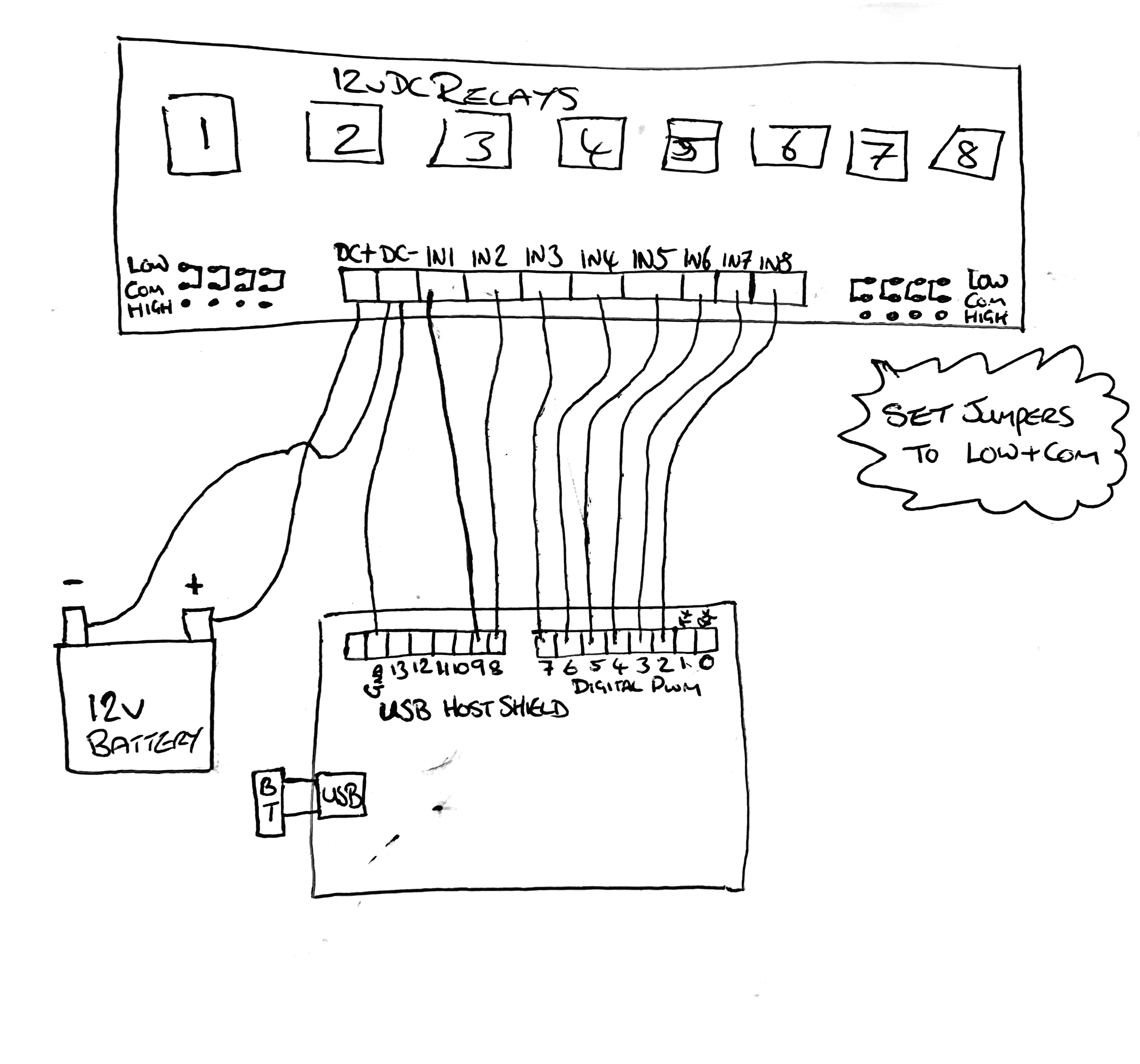

Is it similar to this?
If so, you probably connect +12v to DC+ and the negative of that 12 power supply to DC- .
DC- also to ARDUINO GND.
Still need a schematic of this relay board.
Larryd yes exactly that board.
Thank you I shall test the ground to arduino too and see what happens.

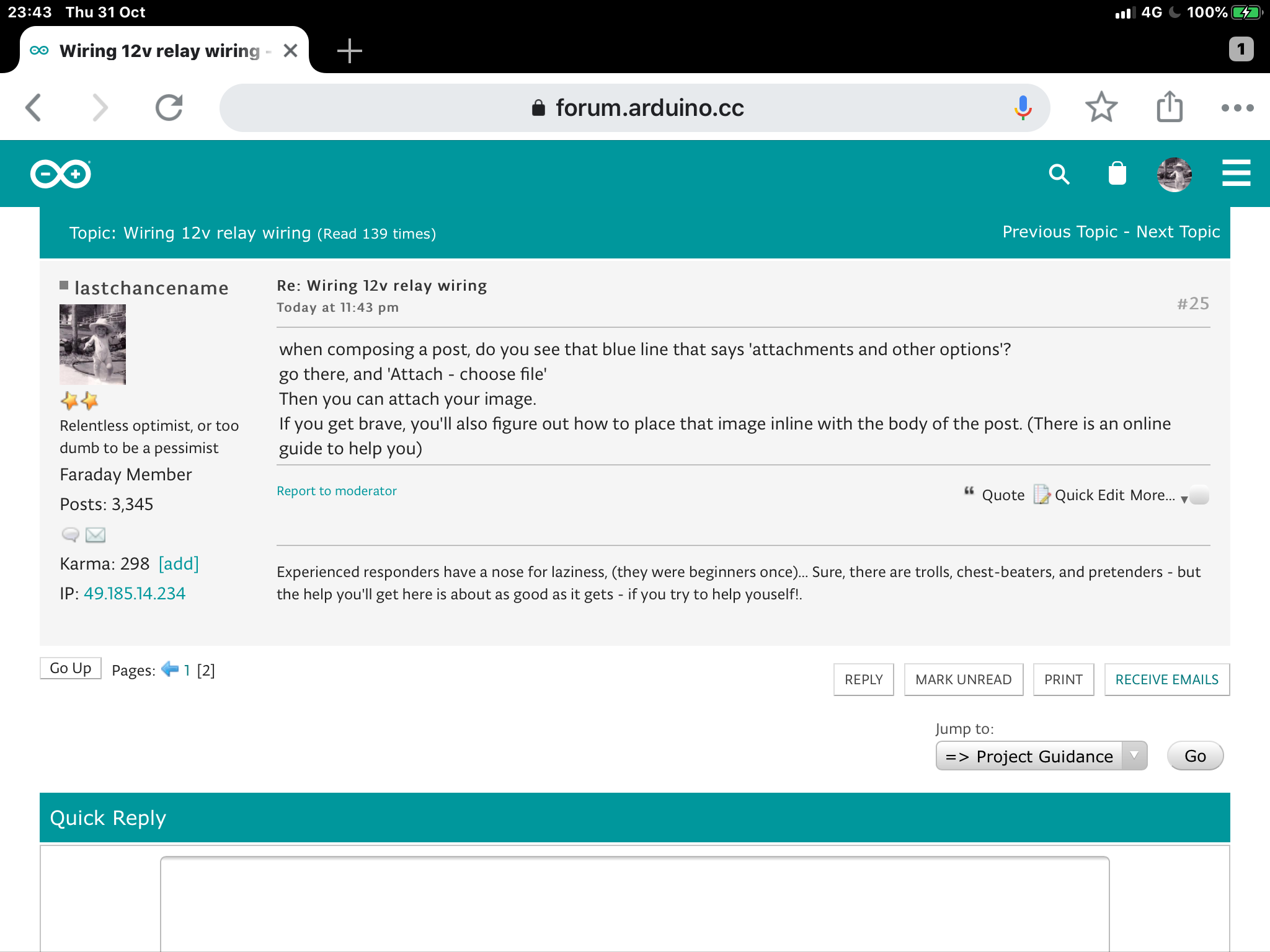

when composing a post, do you see that blue line that says ‘attachments and other options’?
go there, and ‘Attach - choose file’
Then you can attach your image.
If you get brave, you’ll also figure out how to place that image inline with the body of the post. (There is an online guide to help you)

OP, ok, that’s curious, because the screen shot above was from my iPad...!
It wasn’t a camera shot tho’ - maybe there’s a difference??
The wiring looks ok.
Now it’s connected properly, can we see your code?

The spec/info for the relay assembly.
LOW jumpers mean low input to activate the relay.
From the comments in your code you are trying to activate the relays with a HIGH.
So if you are trying to get a HIGH to activate your relay, you need to move ALL the jumpers to bridge HIGH.
Currently the reason the other relays ALL come on is because you have the relays set LOW as activate.
Apart from output 2 relay cycling, ALL the other arduino outputs are currently LOW, so ALL the other relays activate ALL the time.

Thank You Tom! This is exactly my issue ive just found out. I disconnected the jumpers from pins 3-9 and all but 1 went off (pin 2 was connected) so i changed the jumper from com-low to com-high and it works
my current relay is switching all relays in 5 second intervals so my code here works fine now i need to incorporate this into the ps3bt code on each button.
again MANY THANKS to all who have helped me.

Barring any schematic information, I suggest you use the ULN2803 with this relay board, when set to the LOW option (just in case so your Arduino is not damaged).
Edit
In setup() you can make all outputs HIGH (for LOW jumper position) prior to making the pins outputs.
If you do use the 2803, remember it is basically a open collector ‘inverter’.

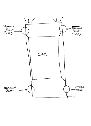

here is my drawing and plan of my project.
One last time, the possibility of your Arduino being damaged with this relay board exists when the Arduino is directly connected to it.
See my previous post.
