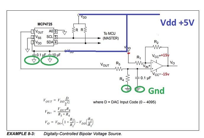

Can you please take a look on the diagram attached and could you please confirm to me if i thinking it right?
Also, i have tracoPower TMR 6-2423WIR and output pins are +VOUT, COMMON, -VOUT
So the opamp takes +VOUT from regulator to VCC+, -VOUT from regulator goes to VCC-, but where does the COMMON goes? Ground?
Thank you in advance.
All the Vdd would be the positive supply of the device controlling the I2C.
If you look the I2C lines have their pullup resistors connected to Vdd as well.
Vdd can only be the control supply for the DAC.
The + and - 15V supplies are just for the output amplifier, which can be, using the equations make the output more than 0 to Vdd that the DAC can supply.
What is a TMR 6-2423WIR?
I assume it is a power supply with + and - and common outputs, common is gnd.

Ok, Things are promising but...
I only get 2.7V all the way to -2.2V over the 4096 scale.i need at lesat +10V/-10V from this setup.
Any advice please?
See connection diagram.
code for reference
