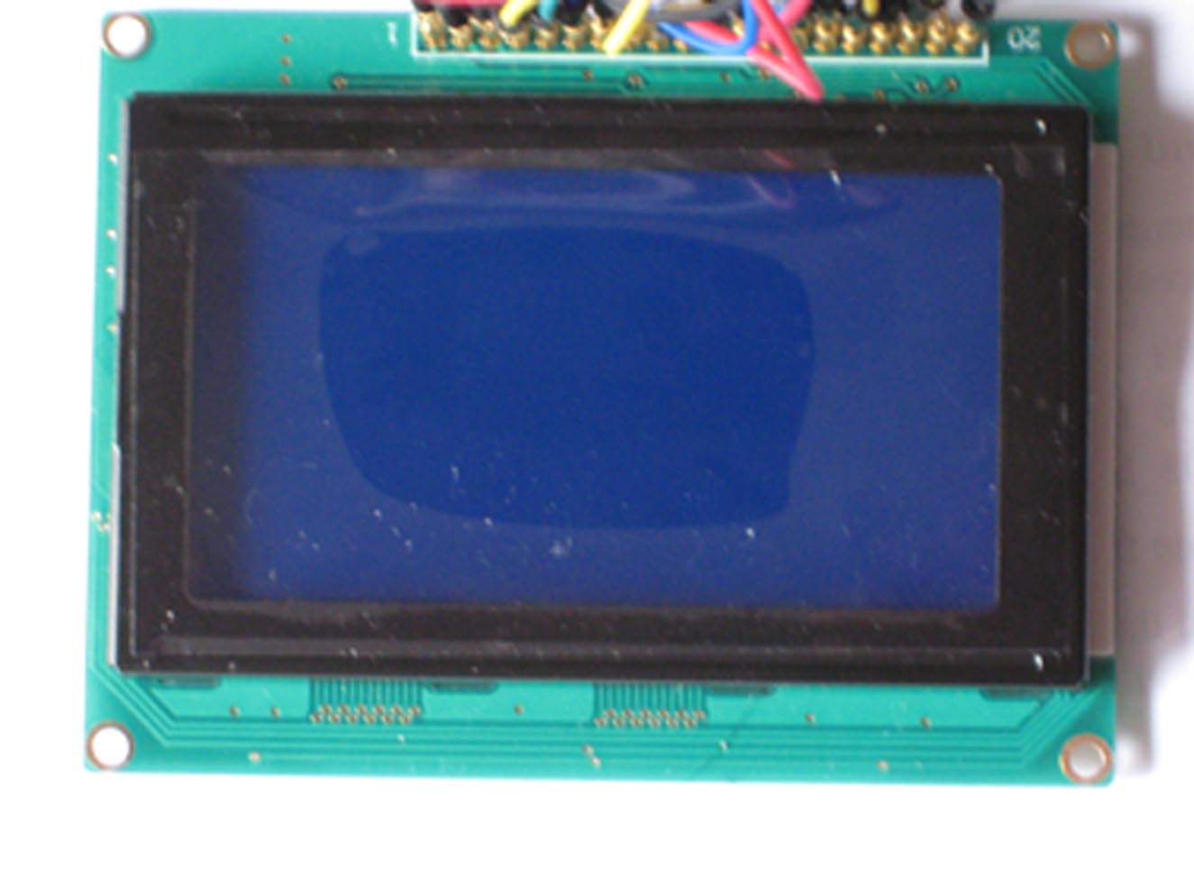

Has anyone managed to connect this board working with the GLCD version 3 ? This board is a KS0108 type.
I followed the guide with ks0108 wiring in columb B of the graphics LCD library page. However, when I uploaded those example files accompany with GLCD library, the process took long time and then the COM port error displayed " COM10 in use, please disable other program ". I could see the panel light up but nothing else.
I tested the wire connections and discovered that pin 17 of the TM12864 board which connects to RESET on Arduino board caused the uploading problem of the sketch. Disconnect pin 17 and the sketch uploads as normal without error but it doesn't display anything. I connected the pot with 3 wires 2, 3 and 18 according to the manual and the table showed.
What else should I do to test the board ? Has anyone got a working wiring with this board ?

I connected the TM12864L-1 board as you suggested but still no go. I could see the backlight and contrast when I did the test last week but now only the backlight lighted up. I just connected the backlight pins 18, 19, 20 and contrast pins 1, 2, 3 to do the test.
  • Connect pin 17 (RESET) to the +5V solved the COM error ( this prevents the upload of sketch).
  • Another question about potentiometer, how do you wire it ? I connected pin 3 of the tm12864 to the middle pin of the pot, pin 18 to 1 leg of the pot and the other leg connected to Ground as the below diagram.
potentiometer
Ground pin 3 pin 18
I wonder if the contrast light is damged !
Tony
Not sure what you mean by this. ks0108 backlights only use 2 pins. Usually backlight pins on a ks0108 module are 19 and 20.
Pin 18 on most ks0108 modules is Vee which is a negative voltage output that is used with a POT to create the voltage
to feed to the Vo contrast input which is often on pin 3.
What did you mean by "contrast pins 1, 2, and 3" ??
potentiometer
Ground pin 3 pin 18
Tony
There is no "contrast light" on a ks0108. There is, however, a negative power supply that creates the needed negative voltage
that is used to drive the glcd modules contrast circuity. This negative voltage is the Vee signal.
Often this is pin 18 on ks0108 modules.
Assuming that pin 18 is Vee and pin 3 is Vo and the Vo signal is on the wiper (center pin) of the pot in your figure,
then it looks like this wiring is correct.
Again, without seeing your modules datasheet, I cannot verify any pin wiring.

Thank you very much for your comment and advise. I am totally new to electronics and Arduino particularly. After reading some information about Arduino I couldn't wait to jump straight into it. So far I have no problem to do the basic test with other components ( sensor, motor, servo ) by following instructions on the net, except this GLCD board.
Attached is the datasheet of the TM12864L-1 board.
I wired the board by following the guide of the table on the ks0180 playground. I used the Pinout B of the table which appears to match with the datasheet.
This is what I did to test the board: ( by followed the suggestion of Ugwick ).
  • Connect pin 19 (+5V) , 20 (Gnd) to the power supply . The backlight lighted up when I connected it.
  • Connect pin 2 to 5V pin of the Arduino , connect pin 1 to Gnd on Arduino.
  • pin 3, 8 and Gnd connect to the Pot ( as on the diagram I draw earlier). Also I tried to replace the Gnd cable with the +5V ( ie, 3, 8, 5V on the pot).
  • pin 17 connect to 5V (arduino) ( if I connect to Reset pin as suggested by the table then the upload will display the COM port in use ).
    With this wiring, I see only the backlight. I wonder if I do need to connect all pins in order to see the contrast.
Before I did the above test, I connected all necessary pins and I could see the contrast appeared on the screen but had trouble with the sketch upload. After I managed to upload the diagnostic and demo sketches, only the backlight and constrast displayed .
So much to learn and I really enjoy the challenge :slight_smile:
Very much appreciated for your help.
Tony

Sorry for my typing error, it should read pin 18.
I used GLCD ver.3 - RC2
The good news is I found the problem, it caused by the faulty potentiometer which controls the screen's contrast. After replacing with another 20K potentiometer, it works perfectly.
In summary, in order for this TM12864L-1 works, the following should be observed:
  1. Use the lgcd library ver.3
  2. Use pinout B on the table of the ks0180 playground or in the glcd doc.
  3. Pin 17 on the TM12864 should be connected to +5V of the power supply, NOT to the reset pin on arduino ( it was Ugwick who found out ).
  4. Use a 20K potentiometer :
  • pin 3 of the tm12864 connets to the wiper of contrast pot ( the middle pin ).
  • pin 18 of the lcd connects to one leg of the pot.
  • the other leg of the pot connects to 5V pin of the arduino.
I will post the wiring table and the pot's wiring soon for people who may have similar problem like me :slight_smile:
Finally, my thanks to Bill and Ugwick who have given me lots of help. It is really a great commnuity.
Tony
