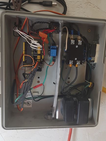

This was my first arduino project and the learning curve is huge! I Completed this project today.

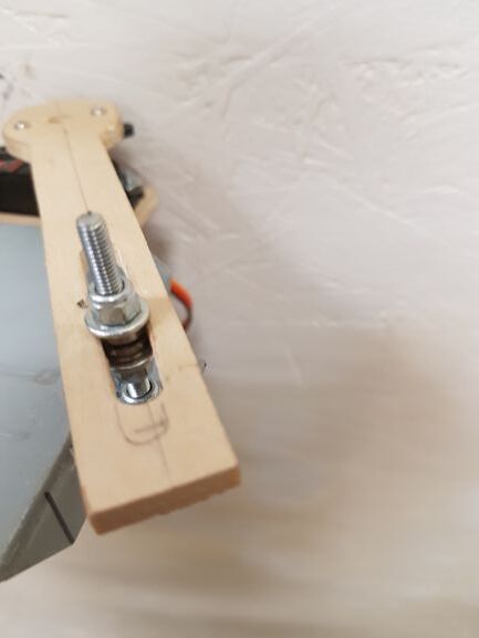

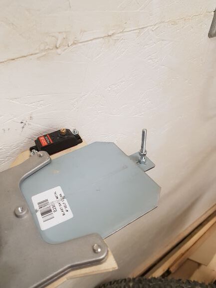

I made the mounts and servo arms from 1/4" plywood cut with a jigsaw (I wasn't allowed to buy the laser cutter!)
I used a 4mm flanged bearing to mount the arms to the 4" blast gates for a more precise control.

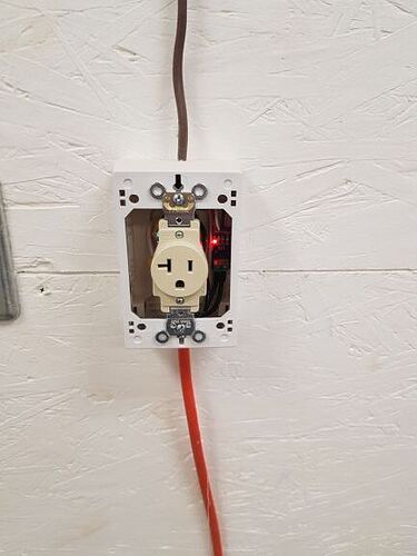

WireMould makes a device box large enough to hold the sensors and a single 15 amp 120 volt receptacle
I mounted the Arduino with the servo shield inside an old junction box I had laying around.
The arduino and the servo shield have their own power supplies.
Trying to find a 2hp contactor with 5vdc coils is a bear, so I used a relay and a Packard C230B 2 Pole 30 Amp Contactor with 120 Voltage Coil. It was reasonably cheap...$20.00 Canadian.
I used b2955 4" Blast gates from BusyBee Tools.
I used bigger servos (DS3218mg) The DS321mg servos are good to move 20kg. of force.
The code is the same as Bob did, after cleaning it up to work with 3 tools and 3 servos.

What kind of relay did you use to control the Packard C230B?
I just bought the parts. Did you have to modify the code much to make it work for you?
