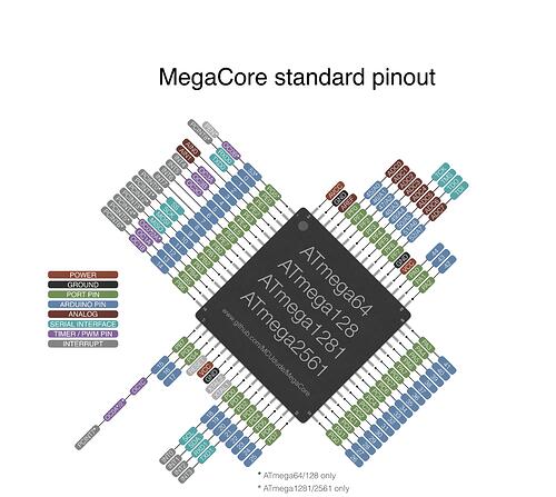

Here's how the display is connected to my current board; I hope it can be made to work! If not, well...I'll trash the first 10 boards and start over.
Port-Uno shield-Pin defined in Megacore
PG1       A0          27
PC0       A1          28
PC1       A2          29
PC2       A3          30
PC3       A4          31
PC4       A5          32
PC5       D2          33
PC6       D3          34
PC7       D4          35
PG2       D5          36
PA7       D6          37
PA6       D7          38
PA5       D8          39
PA4       D9          40
PA3       D10        41
PA2       D11        42
PA1       D12        43
PA0       D13        44
Is there any hope? Have I just royally screwed up?

It looks as if it supports 2561 as well as 2560. If you select the "Breakout" the data bus is on PORTA. If you select the "Shield" it will use the "Adafruit shield" wiring.

You can see that it's just using the 8 bits of PORTA such that PA0 = LCD bit 0, PA1 = LCD bit 1, etc. I need to understand how to change that such that:
PC5 = LCD bit 2, PC6 = LCD bit 3, PC7 = bit 4, PG2 = bit 5, PA7= bit 6, PA6 = bit 7
Looking at the other entries, it seems I would do this:
#else // Uno w/Breakout board
  #define write8inline(d) {                          \
    PORTC = (PORTC & B00000111) | ((d) & B11111000); \
    PORTG = (PORTG & B00100000) | ((d) & B11011111); \
    PORTA = (PORTA & B11111100) | ((d) & B00000011); \
    WR_STROBE; }
  #define read8inline(result) {                       \
    RD_ACTIVE;                                        \
    DELAY7;                                           \
    result = (PINC & B11111000) |(PING & B11011111) | (PINA & B00000011); \
    RD_IDLE; }
  #define setWriteDirInline() { DDRC |=  B11111000; DDRG |= B11011111; DDRA |=  B00000011; }
  #define setReadDirInline()  { DDRC &= ~B11111100; DDRG &= ~B11011111; DDRA &= ~B00000011; }
 #endif
  // As part of the inline control, macros reference other macros...if any
  // of these are left undefined, an equivalent function version (non-inline)
  // is declared later.  The Uno has a moderate amount of program space, so
  // only write8() is inlined -- that one provides the most performance
  // benefit, but unfortunately also generates the most bloat.  This is
  // why only certain cases are inlined for each board.
But, since I'm not really sure what that does, who knows if that's correct or not. It's also looking at the "Uno" section of the code, because that made more sense to try to edit than the Mega section, because the Uno code is already split across multiple ports.

I see you have tried to map the UNO Arduino designation for pins onto the Mega Core pins thinking this makes it compatible. Unfortunately the Arduino pin numbers are abstracted from the real bit register allocations in different processors and this means that bits get scattered inconveniently when trying to use pins as a parallel port (8 bits in this case).
So you have ended up with display data pin to Atmega2561 port bit allocation that is rather inconvenient:
TFT Mega Core port and bit
D0 PA5
D1 PA4
D2 PC5
D3 PC6
D4 PC7
D5 PG2
D6 PA7
D7 PA6
This means you will need to do 6 shift operations to get the bits from the data value into the right bit position in each port, plus all the assocaited ANDs and ORs. So the "Leonardo w/Breakout board" example is going to be a better indicator of how this has to be done.
Essentially what you need to do is use the AND (&), OR (|) and shift (<< or >>) operators to isolate the bits to shift and combine into the registers. Read this too. Dont forget you need to do the reverse shifts for reading the display too (if this is needed) and also you need to set the right bits in the direction control registers of each port.
As David says, the penalty for this rather random bit mapping is going to be slower updates of the screen, whether this matters depends on you needs.
I guess you now realize that mapping D0-7 to PA0-7 would have made life so much easier. If you decide to re-layout the PCB then I would get the rest of your project running using the serial port for debugging in case there are other "gotchas" in the design, and salvage a board by lifting pins and hand wiring up the PA0-7 pins to test the display actually works.
Yes, the port-to-pin assignment is messy. But, the PCB layout is much cleaner. All of this could have been avoided if Port G wasn't broken up all over the processor, but it is what it is. Could I have aligned the port with the display? Yes, if I hadn't been under the impression that the port-to-pin mapping was taken care of by the pins_arduino.h file for Megacore. I simply put the LCD pins in sequence with the "pin number" assignment.
Megacore pinout:
My PCB:
With this layout, the display is physically supported by the thicker uC PCB, and the uC PCB is mounted on standoffs to the front panel-keeping the display in place without resorting to double sided tape or the like.
The rest of the project is well underway-so far half of my digital IO is working, the panel buttons and rotary encoder are working, the analog inputs are working properly, and the serial console is responding correctly. The TWI interface and encoder code both work together, but not on this board yet (development of each section of code was done on an Uno over the last year) and the display code will run, the serial console responds correctly, the control lines are working, but the data bus is still scrambled, so no display yet.
