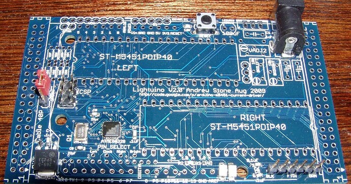

I use the QFN version of the FT232R in my om328p Arduino compatible and initially approached the idea with some trepidation.
The key for me was to use a hot air station and an appropriate PCB with solder stop masks. I got a cheap hot air station for $99. It has also been useful for other projects where I needed to desolder SMD parts.
The process I use is as follows:
  1. Flux the pads
  2. Put some additional solder on each of the tiny pads on the board
  3. Put the QFN part on top its pads as best as you can. It may sit at an angle and not quite fit but that doesn't matter.
  4. Heat up the part and the board with the hot air station. This gives control of the amount of heat and direction.
  5. The solder melts and the part drops down nicely onto the pads. You can gently push the part around on the molten solder and it jump back into position because of surface tension. You can push it from each direction to make sure it is sitting squarely on the pads.
  6. If you need to solder the center pad I usually go back and do that from the other side using a hole that I specifically designed into the PCB.
My success rate has been 100%. If the part doesn't work you can always lift it using the hot air station and start over.
Note that the default Eagle parts for QFN do not meet the BatchPCB 8/8 mil requirement. This can be fixed by editing the part and making the pads slightly smaller.
I'm doing QFN32 with a toaster oven, solder paste, flux, and a fat tip radio shack iron with great success! Frankly I was a bit scared of SMT but now I think that all hobbiests should get into it to take advantage of the great parts available, and the price advantages of having small boards. For example, I put the AVR cpu core (328, clock, voltage reg and assorted caps, resistors and leds) on a section of a board that was about half the size of my thumb.
