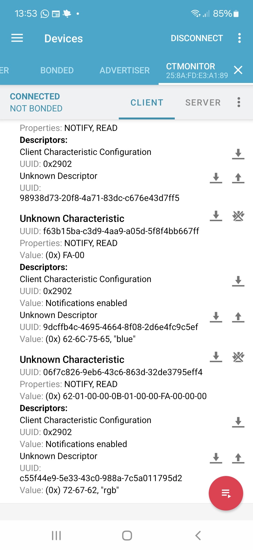

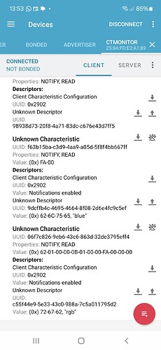

Hi there,
I have done some experimenting with sending rgb values of the nano ble sense in a ble characteristic.
That works, but one thing isn't clear to me. When I write 1 color I get a 2 byte input in the nRF connect app. Fine.
when I send 3 colours in an array, each colour is followed by 2 bytes of 0, so I need 12bytes in total. Is that suppposed to happen or can/should I improve something in the code?
