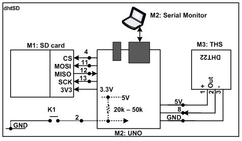

You may get some help from the following example data logger sketch in favor of your project. The features of this sketch are:
1. At the elapse of every 5-minute time (adjustable in the program), the temperature and humidity data are acquired from DHT22 sensor. The value is shown on the Serial Monitor along with Date and Time. The value is also recorded on the SD Memory Card along with Date and Time.
2. While the MCU is waiting to see the exhaust of 5-minute time, it checks if an external Button (K1) connected with DPin-2 has been pressed down. If so, the MCU reads the recorded data from the SD card and shows on the Serial Monitor.

BTW: Mine DHT22 does not work with DHT.h Library; so, I have to include a different library that works with my sensor. Moreover, it looks like that the temperature element of mine DHT22 is working but not the humidity element as the reading is too much (99%).

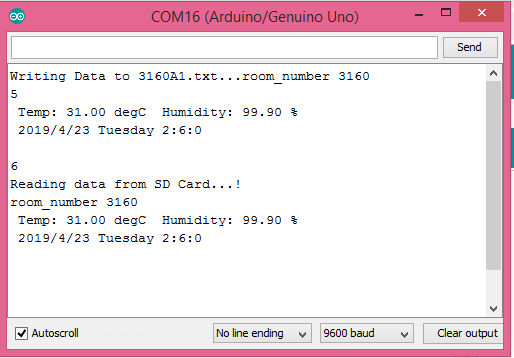

Keep working on the problem of 'stoppage of recording' nearing the end time of 'minute field', and I wish your good luck! In case, you find that you are not getting the solution; you use the following codes (tested) for the 'bcdMinutes()' function: (We will at best miss 1 record -- see screenshot below; whereas, in the past we were missing 11/12 records for the whole 55/60 minutes.)
