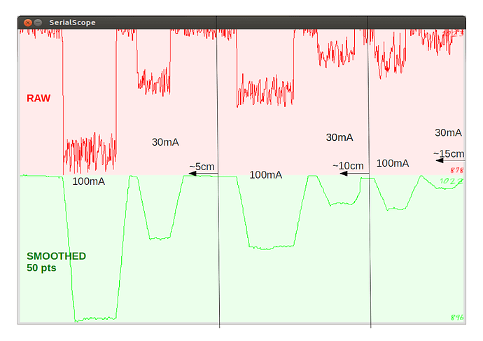

Anyway, sorry for staying quiet but I had put this on the back burner. I tried some more measurements in a somewhat more methodical manner, see pic below:
The top (red) section shows raw ADC readings, the bottom (green) a 50 point smoothed average. The three "windows", labelled 5cm, 10cm and 15 cm show some very rough estimates of the range of the object I used for reference (a spare breadboard) from the receiver.
Each window has two depressions, one labelled 100mA and one 30mA. These correspond to the current being fed to the transmitter at the time of measurement. I wanted to see how much worse things get if I limit current to under 40mA so I can power the transmitter from a pin (so I can turn it off when not measuring).
The results don't look too bad, when considering roughly where the limits of detection are. Looking at the smoothed signal, it is not inconceivable that the 15 cm @ 30mA could be picked up by a simple static trigger, although it would be a stretch (and changing ambient light would destroy this). At 10cm and closer, things are quite a bit better. I 'll have a look at using more than one emitter to see what effects I can get.
Two points:
  1. IR LEDs and photodiodes are available with various beam widths. If you go to http://uk.farnell.com/jsp/search/browse.jsp?N=2031+202996&Ntk=gensearch&Ntt=ir+emitter&Ntx=mode+matchallpartial you will see that you can select viewing angle from 3 to 200 degrees. The narrower the viewing angle, the higher the radiant intensity in most cases A narrow viewing angle (hence high radiant intensity) will work best for your application, provided you align the transmitter and receiver well. Typical IR emitters intended for remote controls have quite a wide viewing angle so that you don't have to point the remote in exactly the right direction.
  2. If you feed the ADC from a source resistance of more than 10K, then you need to take precautions to prevent the increased source resistance affecting the reading. There are two simple ways of doing this. One is to connect a capacitor of 0.01uF or greater between the analog pin and ground. This has the side effect of slowing down the rate of change of the signal, but this is acceptable in some applications. The other is to introduce a delay in the code for analogRead() between selecting the input channel and starting the conversion. The delay needed is about 1us per additional 10K source resistance.

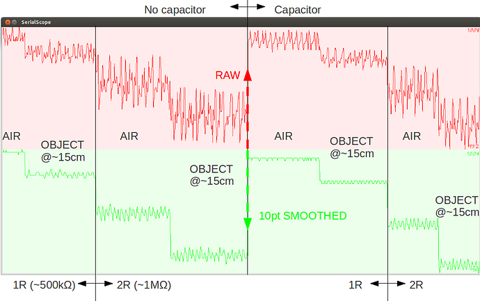

Thanks for the capacitor tip. I tried it out and here are the results.
Three emitting LEDs were always on, drawing around 30mA each, placed around the receiver. The ADC was sampling the receiver and dumping out the raw signal (red) and the 5 point average (green).
I tried to guesstimate what happens at the far limit of detection, around 15 cm (closer than 10cm it's ridiculously easy). The AIR refers to nothing above the receiver. The OBJECT@~15cm refers to a chunk of veroboard placed roughly 15cm above the receiver. I tried increasing the overall resistance to see how far I could push the ADC (and hopefully, the detection). As it turns outthe ADC was surprisingly cooperative. The 1R / 2R refer to one or two series resistors of about 500k? before the receiver. The No Capacitor / Capacitor refers to having a round ceramic cap (561 J | B1 (I think) 64, whatever that means, I don't have another one I 'm afraid) attached between GND and the analog pin as suggested.
Looking at the top (red) window, it is not very apparent if the cap helps, but perhaps it's not an adequate cap. However, software smoothing does quite a neat job. As for detection, the 2R case yields a slightly bigger difference, but nothing to write home about. We are looking at a very tiny range, 1008-952 (ADC units) at the top window and 1004-961 at the bottom. Still, interesting results, I hadn't played with IR before.
By the way, I have no idea what kind of beam my IR LEDs have, but by a very rough approximation, looking at the size of the visible spot they make against an object when seen through a digital camera I 'd say they have a cone of ~60 degrees (give or take a hundred :~).
