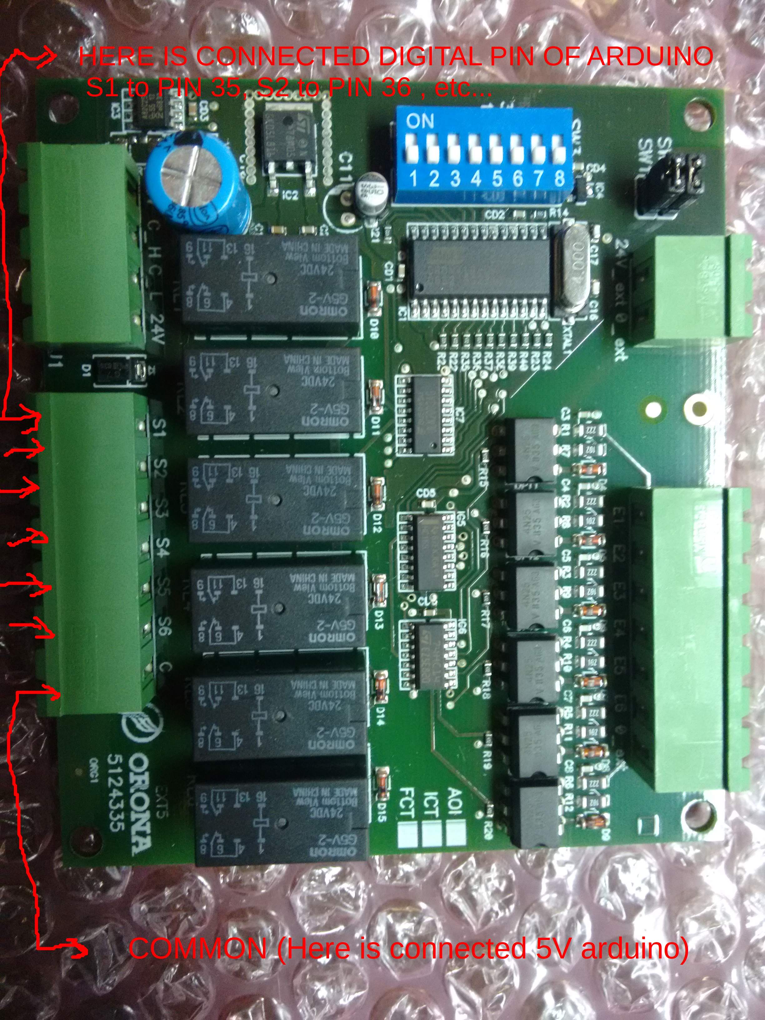

I'm doing a project, which is to use an arduino to read a relay, which indicates several states of the elevator (firefighting mode, going up, down) and the floor where the elevator is located.
The relays are located on boards that are extensions of the elevator, the work of the arduino is only to read the relays, to know when they are open or closed.
I am having problems making these measurements, mainly in relays that indicate the floor number, the arduino makes correct readings, but very often it is interrupted by erroneous readings and thus alternating between correct and erroneous readings, which I think are caused by electric noise
Could you recommend any solution?
Is it recommended that all the digital pins that you are not going to use, initialize them in LOW?
Should I only use capacitors on each pin that goes to a relay?
I am using an Arduino Mega 2560, attached to the other board where all the relays are and I will specify the connection that I have,
I must also clarify that the tests must be done where there is an elevator, so I can not do the tests in my office with more tranquility, I appreciate in advance the help they provide me,
Thank you so much!.

How are the 'S' outputs connected to the Arduino pins?
Do you have pull-downs?
I connected them with a 10-centimeter cable that I got by disarming a UTP cable.
I have not used Pulldown Resistors between the relays and the arduino pins, I'm going to try.
I was reading that the arduino has Pulldown integrated in each pin. Is this true?
Arduino MEGA has internal pull-ups.
Try using them:
  • Change the connection: in the picture you showed the COMMON connected to 5V. Change it to GND.
  • Change the software: when you declare the inputs, use this:
    pinMode(..., INPUT_PULLUP);
Now the pin should read 'LOW' when the relay's output is connected, and it should not oscilate.
Tell us what you get.
I just use 10K pulldown resistors and not changing the code. It makes more sense to me.
Try adding about 1nF to 10nF capacitance to ground on the pins, this should stop almost any
noise, at the expense of slightly delaying the response (by microseconds, which is not as
issue for mechanical relays!).
The problem was solved using a snubber, (capacitor and resistance) at the output of the relay
