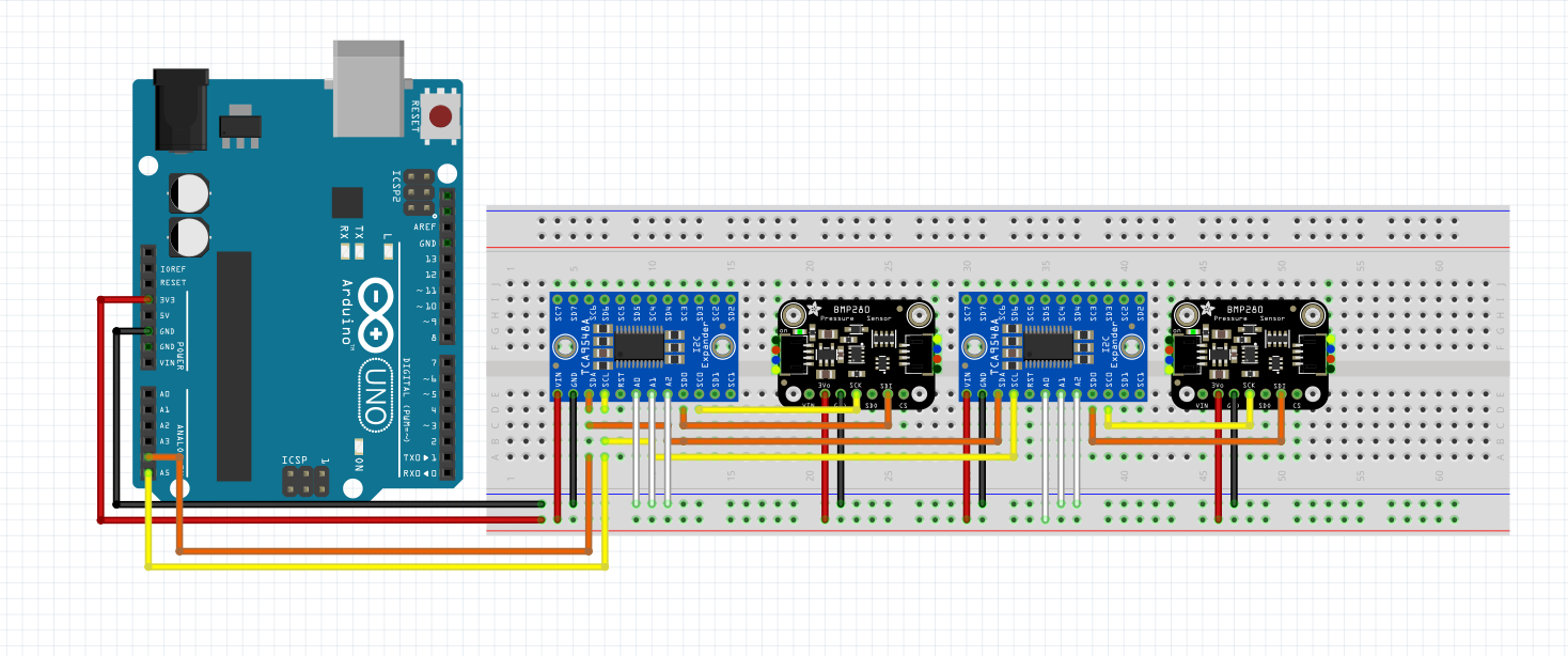

Hi everyone,
I'm working on a project where I need to connect 20 BMP280 pressure sensors to 3 TCA9548A multiplexers to collect and analyze data. However, for now, I'm focusing on just 2 multiplexers. I'am using the redboard from Sparkfun.
The problem I'm encountering is that when I use the second multiplexer, the pressure readings from the sensors on both multiplexers are identical when using the same port.

How is it wired? Please post schematics.
You got the right idea here. Unless you turn off MUX1 before you select a channel of MUX2, you will have 2 sensors on the bus with the same address, which either not work at all, or will give the reading from one of the 2 sensors at random.
Unfortunately, you cannot simply un-comment those lines. The selectMultiplexer() function will do nothing if the parameter is > 7. You need to amend selectMultiplexer() function also so that when it receives 0xFF it sends zero to the multiplexer which will disable all channels.

I don't think it's necessary. My wiring is good the problem come from my code. As PaulRB said I have 2 sensors with the same adress on the same bus.
If you were wondering I do have set the A0 of the second mux on Vcc and A1, A2 are on ground.
I changed this part on the code. And now, I receive data from the first sensor of MUX1 but receive Nan value from the second sensor of MUX2.
Ok, but I don't know what changes you made. Did you try my suggested changes?
Either way, if you want help, post the updated code. A schematic would also help us to help you.

Here is my circuit since a lot of you asked it. I'am using a Redborad instead of arduino UNO because I could not find it on fritzing. This is an axample with only 2 sensors an 2 MUX.
I verified it using just 1 MUX. Then I added the second MUX.
Here is the updated code and you can find the schematic above.

Ok, thanks, I can't immediately see any problems with your code or wiring.
Have you tried swapping over the sensors?
Have you tried swapping over the multiplexers?
Make only single, small, individual changes at one time and test before making other changes.
Try commenting that out.
I might have spotted a problem with your circuit.
Looking at the internal schematic of your sensors
The pull-ups on the left side here connect to the Vcc (=Vin) pin. But your Vin pins are not connected to anything.
The sensor boards have built-in 3.3V regulator and 5V-3.3V level shifters, so it's safe to power all components with 5V from the Uno instead of 3.3V. Use the Vin pins, not the 3V3 pins when powering the sensors.

Thanks for helping me ! Both sensors on each MUX are working. I did the wiring again and it works now. Now I will add the third MUX and all the sensors and see if it works.
Do you understand you only need 2 multiplexers for 20 sensors?
Yes that's right, I can change the adress of the sensors. Thanks
