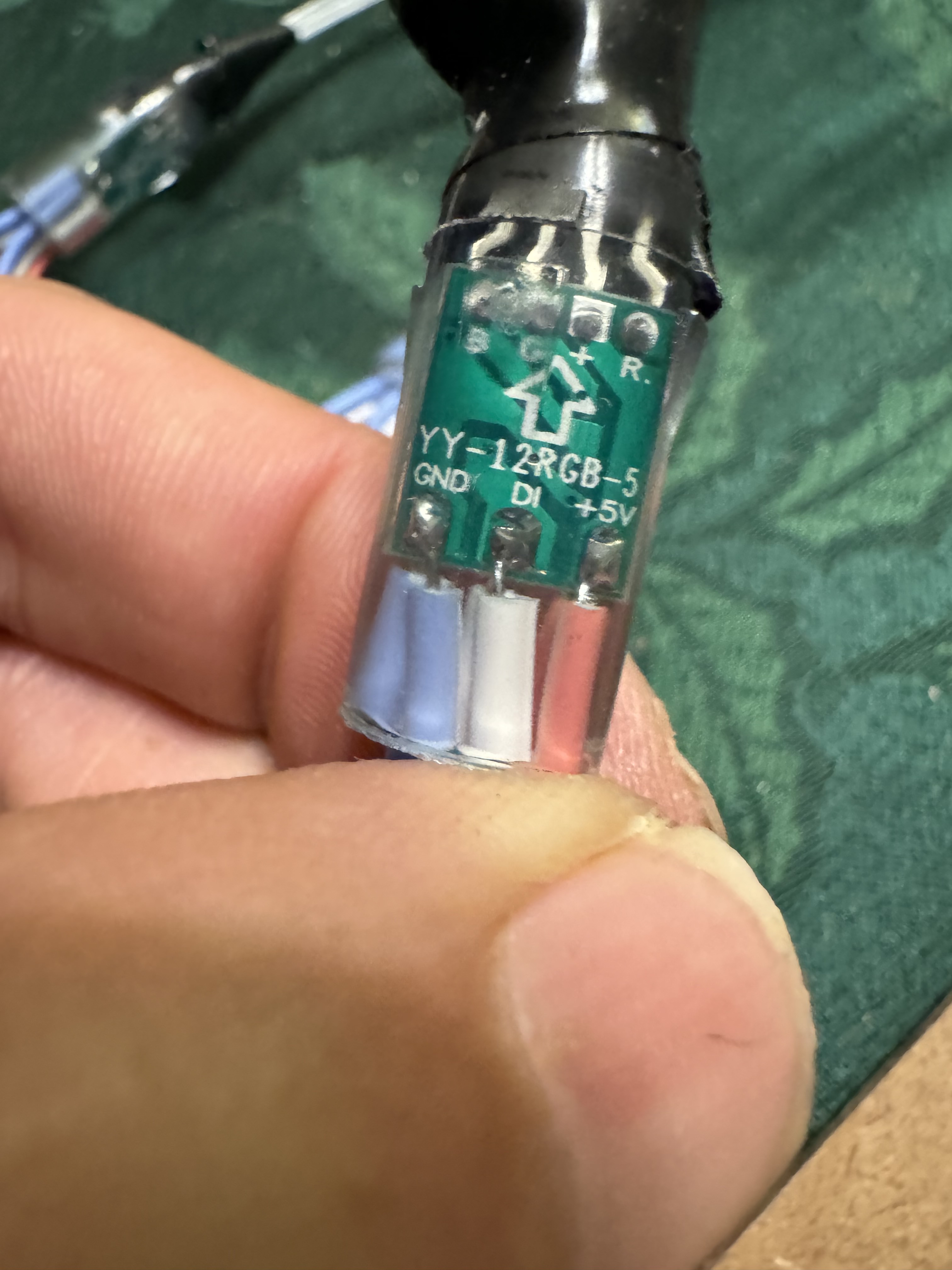

WS2811 data corrupted at at connectors between ws2811 string light
I simply twisted the wires together at the splice point and covered with electrical tape. At the splice point there is about 10 of wire added. I can't find my multimeter to check for voltage drop, however there is no decrease in brightness of lights past the splice point so it doesn't seem the voltage has dropped. Once I make sure everything is working I will solder the splices.

Thanks, the spliced wire is approximately 10 inches. I went ahead and soldered the wire at the splice points. Same result. All lights illuminate when powered however, no lights flicker after the splice.

One interesting thing is when I first powered on all nine of the lights before the splice operate properly but, only the last five of the nine lights after the splice illuminate; however, they don't blink as they should. Then, if i unplug and wait for the electricity to dissipate from the capacitor and then turn back on immediately after the last five illuminate once again and once again don't blink as they should. But, if i wait for several seconds after turning off to turn back on the nothing turns on after the splice.

Okay so I finally figured out why the lights would not twinkle at any point in the string where i cut the wire and spliced back together. It was very simple. Apparently, the data wire only works properly in one direction. If that direction is changed the lights will turn on but will not twinkle or change color.

That is why there are arrows on the strip.

The hints about the data wire being unidirectional are quite subtle. I wouldn't have guessed based on the product information that there's apparently a series diode in the data line. Whatever arrows there are, I don't see them. Pretty amazing OP figured out the problem.
This is NOT a strip. It is a string. There is no arrow designation on the string or information in the product description pertaining to the flow of data.
i stand corrected. Its actually prominently displayed in the casing for the led.
Yes, it is. I didn't see it on the product page on Amazon, however. They might have put it a little more prominently there.

There isn't !! The controller (in our case an Arduino) sends a data signal on the data line. This signal is send to the first chip, which reads the information that is meant for it (the first 24 bits) and forwards the rest via it;s output pin to the next chip, and so on and so forth. If the data signal coming from the controller is interrupted for the minimum time of the frame reset time (50us for latest WS2811, 300us for a WS2812Band older WS2811) the first chip will start to accept new data(and so will all the other chips of course. This is the way the addressing works.
Connecting 2 outputs together may have damaged them although i suspect there are some current limiting resistors on the outputs in this case.
Strings and strips usually come with a couple 3 pin connectors on them, and those are clear male / female type which prevent inverted connectrions.
