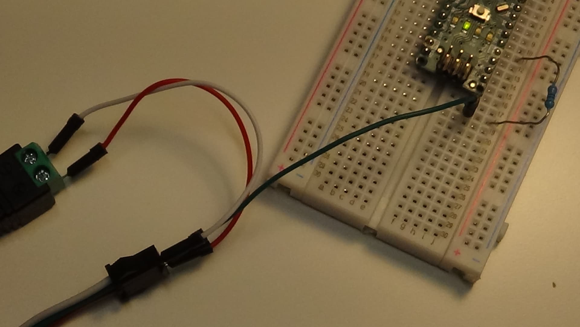

I recently bought WS2811 LED Light strips, but I am unable to get them to work properly.
Pic1|690x345
As you can see from the photo above, the LED strip is red at one tip without any interaction from the Arduino Nano. I'm not sure if I just got a bad strip or if my code is not written right.

Show us a good schematic of your circuit.
Show us a good image of your ‘actual’ wiring.
Give links to components.
How is the strip powered ?
@LarryD,
The strip is powered with a 12v 5a power supply. The WS2811 LED strips were bought off of Ebay (https://www.ebay.com/itm/224091820980?var=522883262154). I am also using a genuine Arduino Nano from the Arduino store. Here is a picture of my circuit, this forum will only let me post one pic.
Pic #2,
Pic #3,
You need a common GND between the Arduino and the LED strip.
@LarryD,
YES!!! I got them working, thank you so much for your help!!!
