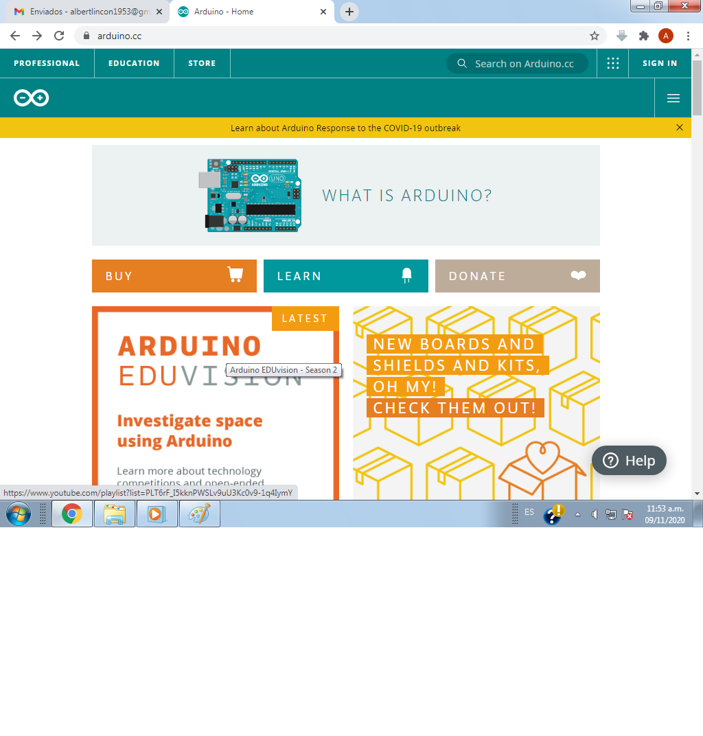

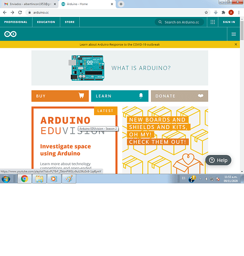

Hi Mark; when you connect to arduino homepage you should have a screen as signin.png
Just click on SignIn and follow.

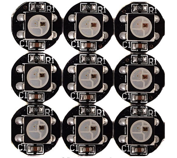

You could use individual ws2812 LEDS like these. (They come 100 to a sheet).
You break them apart and glue them wherever you want them. The downside is that you have to solder four wires to each.
^^ I have them, be careful when buying from cheap source on eBay or Aliexpress. The first batch I got, the pads lifted very easily even when I set my iron all the way down to 250C (a bit more than enough to melt 37/63). Cheap glue binding copper layer to fiberglass base.
