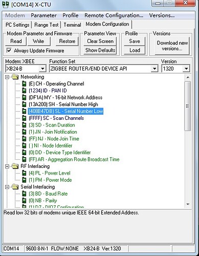

HI , May I ask a question about xbee module wireless communication ? It has confused me for two weeks . The boards are two uno and two xbee shield V3 . I want two build comunication between two xbee modules .The key is that I don't know want king of mode I should use .coordinator API , router AT , or other ways ? my xbee module is series 2 ,XB24-B .
I find that one can't get datas from the other xbee module .Here is a picture of xbee module configuration :
what's the matter with it ?

Fairly easy IMHO. Indeed XBees are complicated in that there are a lot of settings. I highly recommend spending some time in the Product Manual before hooking them up and blindly fiddling with dozens of settings in X-CTU. In most cases, only a very few settings will actually need changing. In other words, there are lots of ways to do it wrong.
Looks to me like the wrong modem type is selected (XB24-B). It should be XB24-ZB for regular XBee-ZB modules (f.k.a. Series 2). But we really would like to know the Digi part number of the model you are working with (e.g. XB24-Z7WIT-004), so add that to the additional information that is needed.

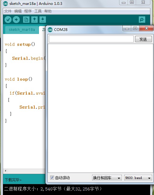

I am sorry I ignore the picture of connection of the two xbee radio .as following : , I use an usb cable to connect it with my pc
Then I configure the two module as following: .After that I edit the code , the one (named A) is :
   Serial.println(random(2,200));
and the other(named B) is :
  if(Serial.available())
      Serial.println(Serial.read());
In order to see datas , I open the Arduino IDE serial monitor . It shows nothing ,as follows:
why it is that ? I want to build communication between the two modules and it can send or receive datas , nomatter it is point-to-point , point-to-multipoint or peer-to-peer topologies .
