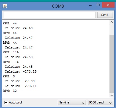

Here is another attempt I did today. This time I get both data in the COM port, but its clearly mixed up and wrong. I got RPM readings when I didn't put the magnet near the hall sensor, and I can be pretty sure my room was not that cold lol
I used a variable called polling number, and incremented it every time a polling signal is sent. If its value is 0 or even, it means its going to poll the temperature sensor Arduino, if its value is odd it means its going to poll the hall sensor Arduino.
I still can't understand where my logic fails.

Hi Paul,
Could you tell me what seems wrong with my code? I tried yet another code today and it didn't work either, I removed the delay() commands too. The polling mechanism seems pretty straight forward. I increment polling_number() every time a data is received and displayed.
Subsequently, the the polling number increments and changes from even to odd, or odd to even. The blocks inside the loop() of the receiver, are divided into :
1. Polling block
2. Condition for reading temperature data
3. Condition for reading hall sensor data
4. Displaying temperature data
5. Displaying hall sensor data.
Are the codes in the transmitters right at least?
Every time you read a character from the XBee, you should print the value and the value of polling_number (which is NOT a function).
You should not need to call XBee.available() but once. If there is data to read, read and use the data depending on the value of polling_number.
What you are sending is still too complex. The XBees should be transmitting ASCII data. Far easier to parse.
I am sending ASCII data, that is why I have the HexCharToValue function.
polling_number is a variable in my code, not a function, yes.
But I don't understand, are you saying I should print the value of the polling_number for diagnostic / verification purpose? I really just need the data to be displayed.
Is there a problem with all the codes or just the code of RX?
I have tried many ways, I can't seem to get the data displayed right. :~ How would you modify these codes?
Why would you NOT just send the value of the integer/float as a string in decimal format? So much easier to deal with.
Yes.
