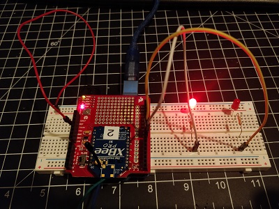

I am using Serial3, so I need to use pins 14 and 15. It was never covered in details but I found a post where it was said to connect the DOUT from XBee Shield to the RX (pin15) and DIN to the TX (pin14).
So I connected the 2 wires (see attached pictures. One is the UNO showing it at work... the other is the 2 wires connections).
The MEGA doesnt do anything. I can see the RSSI light come up stating I received data on the XBee but even serial print doesnt show anything. What am I doing wrong? Any help or comments are welcomed at this time :slight_smile:

Ok well i think this issues gave me lots of headaches for nothing.
I just figured out my error.
By searching online on wiring for the xbee module, I found out that the DOUT of the XBee shield needs to go in RX of MEGA and the DIN of shield needs to go in TX of MEGA. I guess I got confused with the IN going in "Receiving" and OUT in "Transmit"... guess that was common sense except that in fact it was The OUT of shield is going IN the MEGA and the OUT of MEGA going IN the shield :slight_smile:
So I was right.. I did have it working before. Most likely I reversed the wires when installing the MEGA and didnt even noticed.
