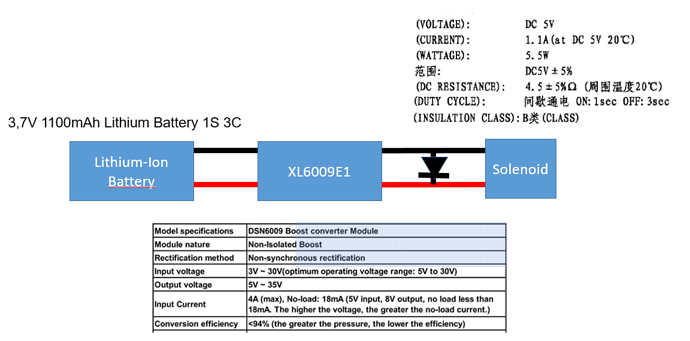

Hi Tom,
thank you for your reply.
I attached a circuit diagram with some information.
Yes I am aware of the high current, but I think the step-up converter should handle that. What I am not sure is about the battery?

In your diagram, does red mean +ve and black GND? Always best to be clear.
This would indicate that the converter is the issue. Do you have a multimeter? Measure the voltage at the output of the converter when it is not powering the solenoid and also when you power it.

I used my DMM and measured the voltage on the battery when I don't connect the solenoid : 3.7 V
When I connect the solenoid I first measure a Voltage of 3.25 V for about 1 s and than it decreases to 0.6 V.
When I measure the voltage at the converter: 5 V without solenoid, with solenoid first 2.3 V for about a second than it jumps to 0 V.
When I connect the solenoid directly to the battery + diode, I measure a voltage of 3.5 V at the battery and it activates.

Your 3.7V Lipo, giving 3.25V output.
Battery Output current, Ibout = Power / voltage = 4.7 / 3.25V
Current out of the battery = 1.47A
Your battery appears to be too small or not charged.

My 3.7 V Lipo Battery 25 C (Link) arrived.
I tested the whole setup again with no success:
Voltage without solenoid connected: Before the DC-DC converter 3.9 V, after the converter 5 V
With connecting the solenoid: Before the DC-DC converter 3.2 V, after the converter 2.2 V
Compared to the other battery, this time the 2.2 V at the converter looks constant but the solenoid do not activate.
When I connect the battery directly to the solenoid (plus diode) I read a voltage of 3.64 at the battery.
So I guess the battery can't be the problem but I don't understand why my converter is the problem? Specs of the converter says optimal input voltage is 5 V but it should also work with 3 V. Maybe this is the reason why it don't work?
I still don't see a link to the exact converter you are using, but it appears to be the problem.
The data I have found on this site states it is a 5V+ converter:
When you use a 1 cell LiPo the converter is showing that it cannot supply 5V when under load.
You may be better off using a 2 cell LiPo pack and a buck (down) converter. Here is an example from the same site, but I'm sure there are many others:
