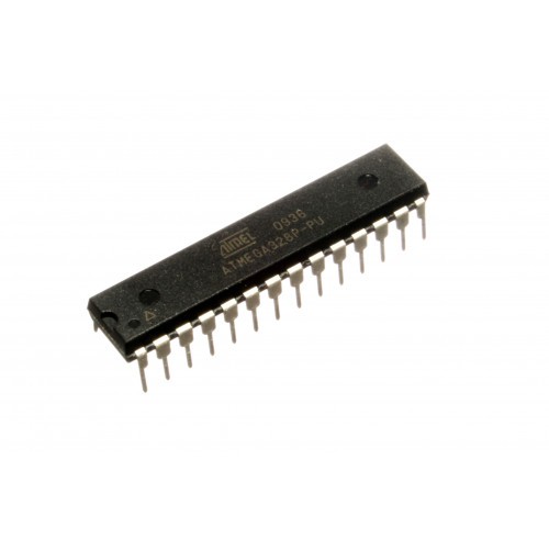

You only need an FTDI if you have an Uno in this form:
You don't need it if you have an Uno in this form:
As you rightly say, in this case, all you need to do is select Uno in the IDE under tools=>board
