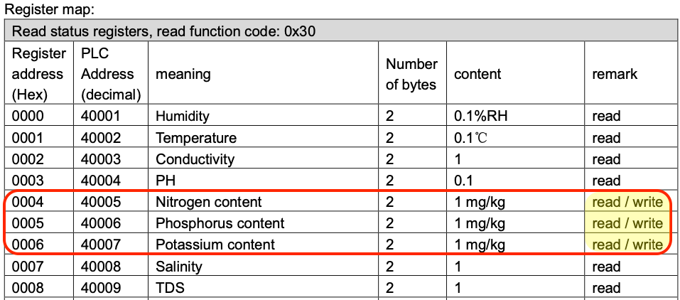

It's not just that. The other strong indication is that the N, P and K registers of the sensor are explicitly listed as read/write, while all others are read only. So the sensor is certainly designed to have NPK values written to.
Are you referring to
I read this as the A (4 bytes) and B (2 bytes) coefficients of the linear mapping functions
ah - I see what you mean now. I went to read the PDF that I had missed and they indeed state
and they provide code for this
so yes, they seem to say that if you don't trust the N,P,K values but you need them for a monitoring system, you could fake those data right into the sensor...
weird (because I suppose the sensor will overwrite those at the next read request)
@J-M-L
I have attempted to use that to write the data in. I assumed this was an error in the datasheet as
attempting to write data like this seems to have NO affect at all. I have no clue what this does.
