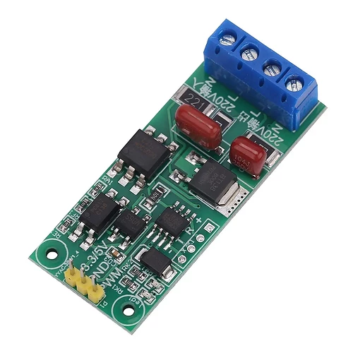

Hello, recently i bought the YYAC-3S AC dimmer module which is controllable via PWM.
I am having the issue that my lamp is flickering when dimming below 200 (analogWrite(pin, 200))
I have tested with both an LED and regular light bulb.
Both have flickering issues but the LED is more noticeable.
I have also noticed that when I upload a new sketch to my Arduino UNO the flickering stops and the dimming effect is as desired until the Arduino is done booting, then the flickering starts again.
Right now I'm not using any loops, I'm just setting a fixed value in the setup method for testing.
Does anyone have an idea what's going?

Sometimes dimming can be unreliable with low-wattage incandescent bulbs (maybe around 10 watts). The same thing might happen with LED bulbs, which are lower wattage for the same brightness.
Some LED bulbs are non-dimmable and some dimmable bulbs work better than others. And the dimming curve is different with different LED bulbs.
I've got some LED bulbs on a regular wall-dimmer and they flicker when dimmed below abut 50%. (They are special "globe-bulbs" and not easily-replaceable with something else.)
...Most microcontroller dimmers use zero-crossing detection fed-back into the microcontroller as an interrupt, instead of regular PWM, but it looks like your module doesn't work that way.

The LED lamp is 4W and the regular light bulb is 100W. The LED is dimmable, i use them all around my house with dimmers.

Then maybe the arduino PWM frequency is too high for the module.
Use pin 3 and try tone(3, 100);
That should generate a 50% duty at 100Hz.
I've tried using tone just by itself and combined with analogWrite.
The lamp is slightly dimmed and not flickering at all, only issue is i cannot dim it now.
Changing any of the values of analogWrite or tone does not change the brightness of the lamp, just using either separate or both combined.
EDIT:
Using values above ~500 will cause the light to start flickering, but has no effect on brightness.

That is not zero crossing, as you are not in sync with the mains frequency. Also mains has 100 Hz zero crossings, not 50 Hz. You're just producing a 50 Hz PWM signal for the controller to handle. The listing says it can do up to 500 Hz, apparently it has trouble dealing with that.
The design of the circuit board, by the way, is beyond terrible. It's outright dangerous. There is NO high voltage separation to speak of. There are traces that belong to the mains side running right next to traces that belong to the low voltage side at the TRIAC. The PC817 optocoupler (likely for the zero crossing pulse) is placed right next to the bridge rectifier. The microcontroller is surrounded by components that are part of the mains circuitry, no spacing to speak of. I recall there should be about 8 mm of circuit board separation between the high and low voltage sides, this board has less than 1 mm separation, which can easily be bridged by mains voltage, especially when there are power spikes. Tracks of both the high and low voltage side run even under the MOC3020, which is ridiculous. There should be an anti-tracking slot under that opto instead.
With this level of isolation, the moment you connect your Arduino to this board, you should treat your Arduino and everything that it has connected to it as if it is mains connected. It's design is terrible, just terrible.
Probably the software running the thing is of similar quality, as your flickering issue indicates.

50 Hz is the full wave; you are triggering at each half wave (both the negative and the positive halves). There are two zero crossings per full wave, so 50 Hz AC has 100 Hz zero crossings.

So as I suspected and as you have verified, you need to use a PWM frequency less than the UNO 490Hz.There is nothing wrong with the board, you just need to use a lower PWM by manually creating a PWM signal in your code.
If you find another module, you may have the same exact problem.

Then you're doing something very wrong, as in phase cutting the switching pulse to the TRIAC (through a timer interrupt) always comes at a different time from the zero crossing pulse (through a pin change or external interrupt). Even having that timing a little bit off will not cause flicker, for that you must be missing at least one half cycle and probably more than that.
What is more of an issue is that LED lights and phase cutting dimmers are not good friends. Unless specifically designed to use with such dimmers they may flicker, or simply switch on at full brightness from a specific point in the phase cutting.
