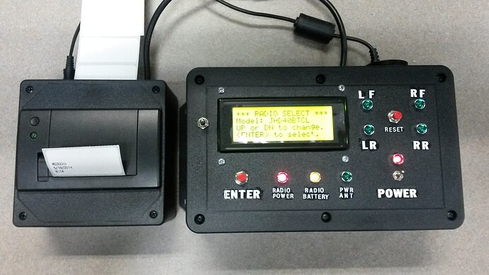

I have built a project for work that reads speaker lines and tests continuity. Once the test is complete I print the time, date, and part number on a thermal label that gets put on a wiring harness. I have tried using the common thermal printer for labels from Sparkfun. While it kind of works, the print starts dark on the left and the right side is completely light and unreadable. If I just print on thermal receipt paper it works fine. I'd like to be able to connect to our company's Zebra label printer. I have an RS232 shield and would like any help connect a MEGA to the Zebra via the RS232 shield.
