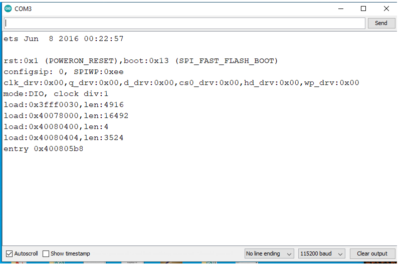

what is wrong with post #10 ? I used the tags, and it is a complete sketch.
error
webpage.h: No such file or directory
Post #10 is perfect. But then in post #19 you posted a screenshot of your code. Posting pictures of text is not helpful.
That error is expected from the code in your screenshot:
Line 19 has the incorrect syntax, which will cause the error.
You have the correct syntax on line 18, but that line is commented out.
Delete line 19 from your sketch, uncomment line 18, and then try compiling again.
I was trying both cases = error the same

Arduino: 1.8.13 (Windows 10), Board: "ESP32P4 Dev Module, Disabled, Disabled, USB-OTG (TinyUSB), Disabled, Disabled, Disabled, UART0 / Hardware CDC, Default 4MB with spiffs (1.2MB APP/1.5MB SPIFFS), 360MHz, QIO, 80MHz, 4MB (32Mb), 921600, None, Disabled"

Alternatives for webpage.h: []
wifi_voltmeter:18:10: fatal error: webpage.h: No such file or directoryResolveLibrary(webpage.h)
  -> candidates: []   18 | #include "webpage.h"
Multiple libraries were found for "WiFi.h"
compilation terminated.
That is unexpected. Please make a ZIP from the "wifi_voltmeter" sketch folder and attach the ZIP file to a reply here on the forum topic. Maybe we will be able to spot the problem by looking at the sketch files.

I fixed what you have suggested, no errors = THANKS
But device does not even trying to connect to WiFi network
The sketch program is configured to do serial communication at 9600 baud:
but you have the Serial Monitor configured for 115200 baud. So this means you won't see any of the serial data sent from the sketch program in Serial Monitor. The reason you see some content in Serial Monitor is because the boot ROM on the ESP32 prints some diagnostic information at 115200 baud on startup.
So select "9600 baud" from the menu at the bottom of the Serial Monitor window and you should now see some output from the sketch program. Even in the worst case scenario where the board is not able to connect to the Wi-Fi access point for some reason, you should still see something like this:
(the program periodically prints . characters as an indicator that it is trying to connect to the access point)
I think a better solution would be to change the baudrate in the sketch to 115200 - so you see both: the output of the boot ROM and the output of the sketch.
Did you set ssid and password in the sketch according to your WiFi Network?
