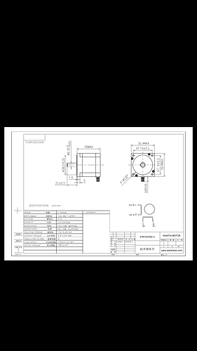

Ok yes that makes sense. Thank you. I included an image of the data sheet for the motor I'm using as well. If the image is too small the link is
That motor requires 2 amps and I don't think you will get that from the A4988 on a BigEasydriver - it will probably overheat at about 1.2 amps. I have no experience of them but the TB6560 is supposed to be able to provide 3 amps so I reckon it should be good for 2.
Otherwise you will need to get a much more expensive industrial stepper driver.
OR ... maybe you don't need the full torque of the motor and it might work OK with a lower max current, or you could get a motor with a lower current requirement.
