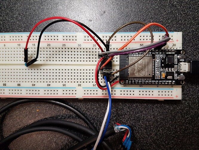

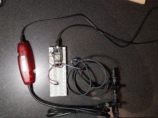

Hi to all, thank you Timo for your work.
I m a beginners, but i wold you like to send some data from my ESP32 to N2k network.
I bought one NGT-1 usb gateway, to verify the data trasmitted from my ESP32.
I follow your guide, and i see temperature reading to NMEA reader via serial.
The next step is connect ESP32 to N2K network and read data from my ngt-1.
I connect GPIO4 and GPIO16 to MCP2562 pin 1 and 4 like this schema:
https://github.com/ttlappalainen/NMEA2000/blob/master/Documents/ArduinoDUE_CAN_with_MCP2562.pdf
But i cant read data in NMEA reder via NGT-1.
Where is the error?
Thank You
Emiliano
With quick look your connections seem to be OK, except I could not see is NGT-1 powered on NMEA 2000 side? You have to feed 12V to NMEA2000 bus, otherwice NGT-1 tranceivers will not get powered and it will not listen/send anything.
On NMEA Reader you can also allow NGT-1 to receive all data. Select Edit-Preferences...-"Transfer: Receive all"
Ouch!!!
Thank You Timo, il try to feed 12v.
:slight_smile:
Edit:
All work fine!!!!
Thank You Timo

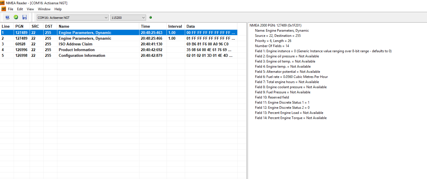

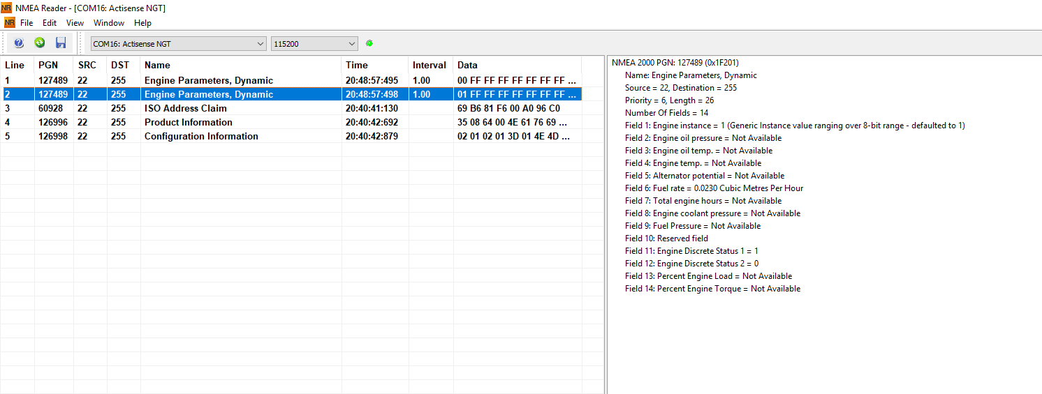

An other question....
I have two engine, and i send the flow fuel rate of each engine to NGT-1.
engine0---> 56 l/h
engine1---> 23 l/h
This is my code:
SetN2kEngineDynamicParam(N2kMsg,0,N2kDoubleNA,N2kDoubleNA,N2kDoubleNA,N2kDoubleNA,Engine0Flow(),N2kDoubleNA,N2kDoubleNA,N2kDoubleNA,N2kInt8NA,N2kInt8NA,true);
NMEA2000.SendMsg(N2kMsg);
SetN2kEngineDynamicParam(N2kMsg,0,N2kDoubleNA,N2kDoubleNA,N2kDoubleNA,N2kDoubleNA,Engine1Flow(),N2kDoubleNA,N2kDoubleNA,N2kDoubleNA,N2kInt8NA,N2kInt8NA,true);
Why in NMEA Reader i see
Engine0 ---> Fuel rate 0,0560 Cubic Metres Per Hour
Engine1 ---> Fuel rate 0,0230 Cubic Metres Per Hour
