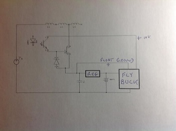

Dos this look like a practical switching proposition

Real problem.
I need a variable inductor I can control digitally,
I don't want mechanical.
Its for psu smoothing where capacitive does not work.
Here they refer to a dc bridge.
http://www.ijcee.org/papers/278-E747.pdf
Following the references finds other papers with somewhat circular reference with none adequately
describing its implementation.
I experimented years ago with similar and had little joy.
Its rather lossy at anything but a fixed frequency.
For wind power that's a bit problematical.
Rough experimentation with a kludgy homebrew variable inductance made me believe that this was the solution.
I am truing to devise an experimental rig controlled by an arduino to test further.
If anyone has better ideas I would like to hear them.
The actual implementation will likely have 10 or so taps, initially and I wish to keep cost down.
I would like to be able to compare as many motors as possible over a range of 50W to perhaps 2 KW and I am not sure yet what the inductance is likely to be required.
It looks like I have made a bit of an error in my sums.
Inductance range should be 0 to 2 H.
In principle its identical to avr used for generators in the 50 s.
Just a different implementation.
Boardburner2:
No, it will explode - did you read my previous post?
Ok so I have to take off line before switching.
That's not a problem for test purposes I figure a couple of cycles with zero crossing switching.
Is this feasible.
A motor driven inductor may be a better solution but these days I have no idea where I would find one.
Edit I have seen the results of switch gear arcing.
I m testing at low voltage deliberately and power components are going in a 1/8 steel box.
I think the damage will extend to everything but the inductor. I don't think it would be damaged.
You might cause insulation breakdown in the inductor too...
You know how old car ignitions worked? Basically like this but with a much
smaller coil.
