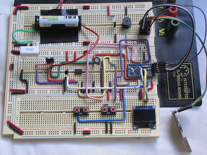

I'm wanting to try build a 1.2V NiMh battery capacity tester.
Looking at other projects online, it seems I essentially need to measure the battery voltage accurately, set the minimum voltage to be achieved (0.9V), apply an appropriate resistance load across the battery, include calculations in the code to know when to stop and then display the results on a small display.
I've spent quite a bit of time trying to adapt a circuit I found on line (https://www.instructables.com/DIY-Arduino-Battery-Capacity-Tester-V20/), however when I try to drain the battery via the mosfet suggested (IRLZ44N), a 1.2V battery doesn't seem to open the gate. I think I read it needs around 3 or 4 volts.
What I'd like to know is, could I create a circuit using parts that I have - either Darlington Arrays (UNL2003A) or power shift registers (TPIC6B595). The darlingtons seem to be able to handle 500mA per driver(?) and the shift registers 350mA per output.
I thought that I could maybe write to use a combination of outputs in parallel to drain the battery at the rate I nominate via a number of resistors. Could someone please let me know if this is possible and if so a hint of where I can start. Note, I'm a bit of an electronics novice.
The battery doesn't drive the gate, the opamp does.
That circuit should work, even with the limited (2.5volt) gate drive the opamp can provide.
Forget about ULN2003 darlington arrays.
They also have a current limitation for the whole chip, and that's a lot lower than you might think.
About 80mA per output if all outputs are used (see the graph in datasheet).
The author used a metal screw on the fet without plastic TO-220 spacer.
That could easilly short the battery (to the grounded heatsink).
Leo..
Thanks Leo for the reply.
My issue with the mosfet was that it wasn't even getting warm when draining the 1.2V battery. However, when I connected a 3.7V Li-ion battery, it then started to heat up (needed a sink). So I have no idea why it's not working.
Not "getting warm" does not mean "not working".
Hint: power (heat dissipated) = V^2/R, where R = MOSFET on resistance.
The LM358 will not give you VCC on its output, it is not a rail to rail output. You could add a pull up resistor to accomplish this. The ground of R3 should be also connected directly to the DUT ground. Check you gate voltage without a battery, if it is wired correctly it should be about 5V (VCC). If not you either have a bad part or it is miswired. I would not recommend this circuit without some protection for A0, it will be fried if a good 9V battery is connected.

I think what you really want here is the ability to select a discharge rate that is based on a fixed resistance, or constant current, or constant power.
In the first case, voltage and current will both decline. In the second case, voltage will decline until the battery can't produce the set current any more. And in the last case, voltage will decline and current will increase, until the battery can't produce the desired current. All interesting data!
When you discharge a 1.2volt battery with 1Amp with a mosfet and a fixed 1 ohm resistor,
then the 1 ohm resistor gets 1 volt and the fet gets 0.2 volt.
0.2volt 1A is only 0.2watt. Not enough to heat up a heatsink.
The heatsink only gets hot with higher battery voltages.
~3.5 volt from the LM358 minus ≤1volt when the source resistor has 1volt across (1 Amp discharge) is still 2.5 volt left to drive the gate. That should be enough for 1A through a logic level fet.

Hi Gil(?).
Thanks for your reply, but I do have some questions if I may. Please see code at the end of this reply.
I'm using an Nano, 3.3V unit. I'm supplying external power from an adapter (5.15V).
The arduino is being powered via the "RAW" pin and "GND".
  1. Am I correct in saying that the LM385 is used as a constant reference voltage (read in pin A1 - Vref_Pin - line 94)?
  2. Is it correct to have only 2 pins of the voltage reference connected - Pin 1 & 2?
  3. The voltage across GND and this Pin 2 is 3.90V. It that what it should be? How can I check?
  4. You mentioned the ground of R3 should also be connected to DUT ground. I've connected all grounds together (including the battery). Is that correct?
  5. I measured the Gate voltage without a battery as you suggested. It's 4.12V. With the battery, it's 1.816V. When connected and running, it measures 1.920V at the lowest mA setting and 4.12V at the highest mA setting.
  6. Your suggestion for protection of the A0 pin? Is this a 10K as Wawa noted? Do I connect it btwn GND and pin A0?
  7. Lastly, I don't get what line 31 to 33 in the code are doing - how they are adjusting the current/PWM values. When I toggle with SW2 button, it goes from Curr = 51mA & PWM=3 to Curr = 103mA & PWM=7, up to Curr = 999mA and PWM=76. I assume that 76 is the "duty cycle" ranging from 0 to 255?
If I have a AA NiMh that is 2800mA, should I be discharging it at 280mA (1/10 capacity)? If I discharge it faster or slower, would the capacity read about the same? What if I then connect my 10,000mA D size batteries. What discharge should these use?
Sorry for the zillion questions. I'm a bit of a newby here and wanting to make sure this is accurate. My long term is to build one of these for each of my 4 kids as well as an inbuilt charger to handle 4 AA's. I'd also like the unit to display the internal resistance of the battery to show if their still ok.

Made one once, years ago. Simple enough, ran constant current and timed the discharge down to a constant 0.8v per cell.
Didn't have Arduino back in those days so more than likely simple enough without one still these days..
Have a look at the LM358 Datasheet.
It can be programmed with 2 resistors to give voltages between 1.2V and 5.3V.
For 1.2V, no resistors are required but the Feedback pin should be connected to GND.
Gilshultz,
I placed a 10K from D10 to ground. Thanks for the suggestion for startup. There was occasionally an issued in it starting up. That part is fixed.
As for the diode across A0 and 5V for a 24V battery, I don't really get it. I'm only going to run it with a 5V supply.
Also, when you get a chance, can look through my post#12. Ta.
Wawa, thanks for this reply an the link, but it's a little over my head.
Are you recommending with my circuit that I add say a 150 ohm resister in line between the gate pin (pin 1) of the mosfet and pin 1 of the LM358 op amp?
You mean LM385 (voltage reference), not the LM358 (opamp).
A Schottky diode between A0 and 5volt can protect the Nano pin in case battery voltage becomes higher than Arduino supply. That protection must also include a 10k resistor between battery and A0 (in series). When that resistor is used, the diode is sort-off not needed anymore.
More replying to gilshultz, but yes,
commonly done if the mosfet is driven from an Arduino pin (see link in previous post).
Not really needed when the mosfet is driven from an LM358, because the output of that opamp is over-current protected.
Leo..
Hi Leo.
Can you check the following changes are what you were suggesting (R7, R8 and D1) - where D1 is a schottky diode BAT48 (as it's the only type I have) :
I've also added a 10K between pin 10 of the arduino and ground.
Ignore the 150 ohm resister in my case - :+1:
Move C1 (220uF) to the other side of R7, where it was before.
C2 (100n) can stay where it is.
Can't hurt to use two 100n caps, one on each side of R7.
BAT48 is fine.
Leo..
Done.
