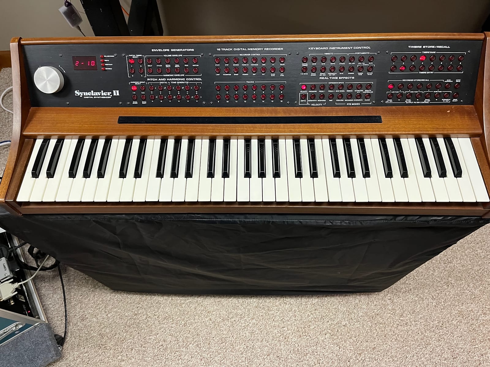

My bad for not being clear in my post. I’m using the Control Surface library to build a MIDI controller to control the soft synth Synclavier V by Arturia, a replica of the Synclavier.
I know how to build a controller using upwards of 40 potentiometers to control the parameters but I’d like to design it to copy the original keyboard which has 128 red buttons but only 1 knob to change the value of the parameters.
Normaly, each pot would have a Control Change number (CC) to control a different function but in the original design, you use buttons to select the functions and 1 knob to change the value.
I can assign every button a CC number I I need a way to pass it along to the pot to change the value.
Here a picture of the original keyboard to give you an idea:
