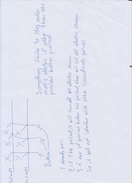

Now I am drawing a sketch how I am thinking.
That means you are not thinking correctly and logically.
You have been given all the answers to solve your problem, if you do not understand something then ask about it.
Here's attachment
Sorry but I can't make sense of your diagram.

Well there is not much coherent thinking going on in that diagram.
The closest it looks like is a switch matrix.
Is this what you are looking for?
Isn't it possible to making that the previous button turns off automatic if I turn on the next button something similar to the smoke starter in a car if it runs too hot?
It is to save pins.

Qwseyvnd:
Most button switches turn off as soon as you lift your finger off them. How you use the Arduino to interpret what the buttons mean is up to you.
You can get button switches that latch in the on position and need a second push to switch them to the off position - don't use them.

You said that. Why don't use them ?
I said that the previous button turns off automatic if I press another button, not this you described.
  1. There is no need anything you can do with a push on / push off button you can do in software.
  2. Having a switch permanently pressed makes a mess of the scanning matrix and you have to use diodes to prevent ghost key presses.
Qwseyvnd:
This is getting ridiculous ...
The only reason I mentioned the latching switches was so you knew the difference between them and non-latching switches. I was not / am not sure which sort you have.
You did not previously say
"I said that the previous button turns off automatic if I press another button"
In Reply #14 you asked
"Isn't it possible to making that the previous button turns off automatic if I turn on the next button"
I can only go on what you write - not what you would might have intended to write.
...R
