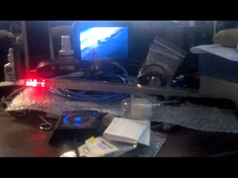

Strykeroz, I know this thread is sorta old-ish but I wanted to thank you for your Larson code. I borrowed it and modified it for a 40-led circuit.
The 40 leds are my cars 3rd taillight. I will program this to be a normal brakelight but when the car is stopped, they will start scanning back and forth.
Here's a video of my circuit in action.
~Mike

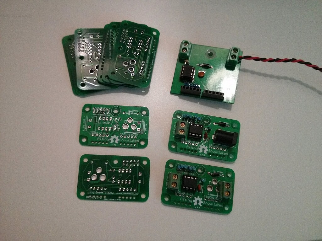

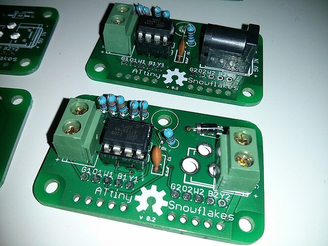

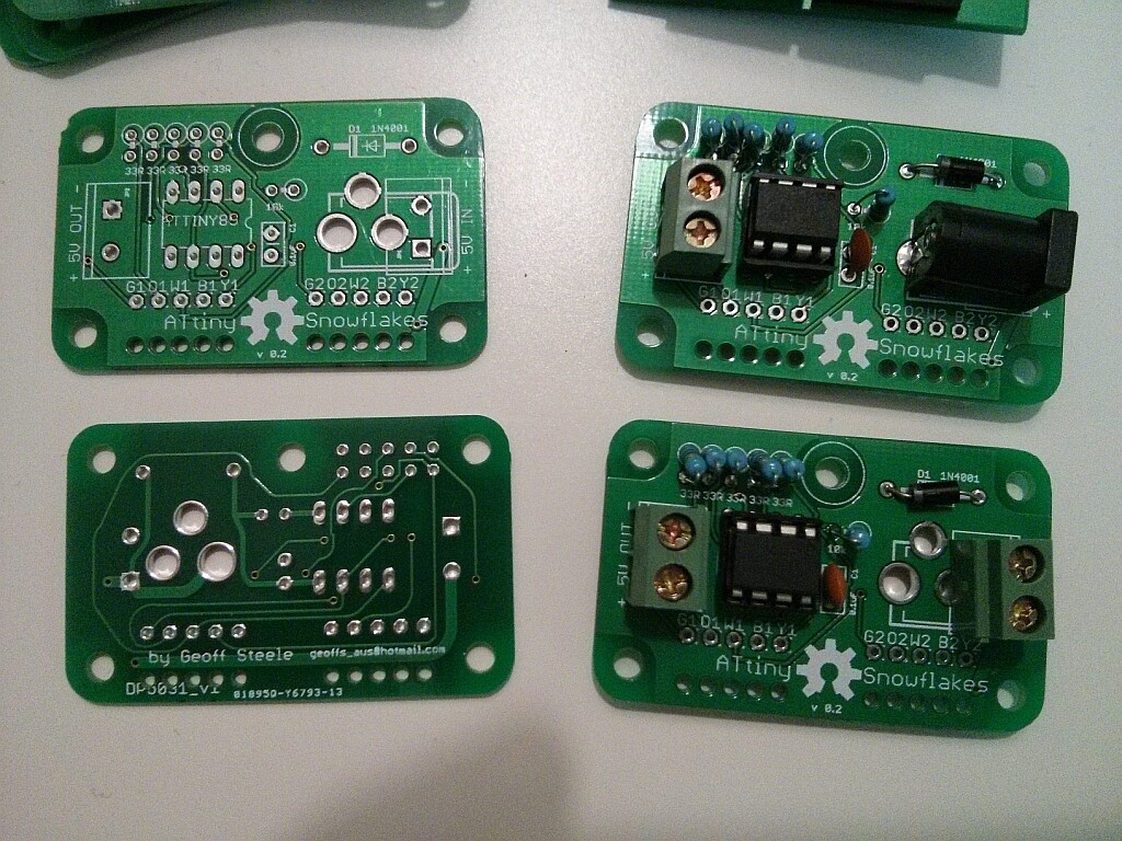

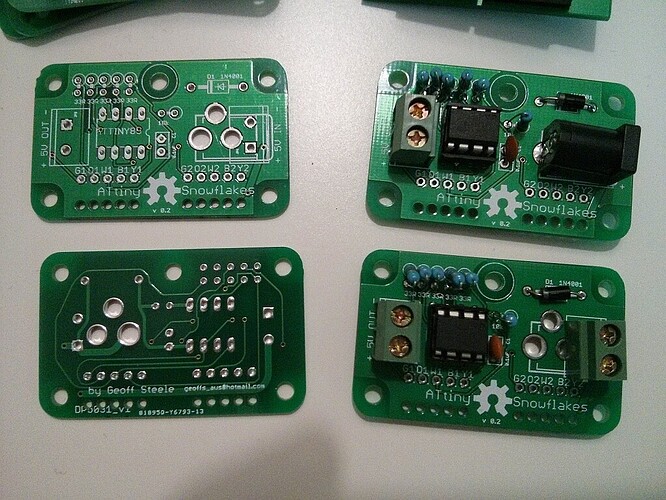

I'm overdue for an update here too I guess. Since last posting I've had two versions of the circuitboard made up at Seeed. The first was to prove that my new EagleCAD skills actually translated okay to the real world. When it came back fine I've moved to the smaller 50x31mm board in the DP sick-of-beige PCB size which is far more compact, and I added a footprint for a 2.1mm DC jack sharing the space of one of the two screw terminals.
The idea is these boards will daisy-chain together for power with the end board in a chain having a wall wart plugged in via the 2.1mm jack. Each is standalone with a diode for polarity protection. At the bottom are two groups of 0.1mm spaced terminals for the string of LEDs to connect to, via a row of holes for strain relief. The larger hole at the top centre takes a curtain hook or ring, to hold it to a curtain rail on the inside of a window.
In the attached photos you'll see two of the boards populated along with the front and back view. In the group shot the board at the upper right is the v0.1 first attempt for scale.

Are the PCBs holes for the barrel jack the correct size? They look huge. Did you use the Adafruit Eagle library?
[quote author=Coding Badly link=topic=135596.msg1268000#msg1268000 date=1370480096]
[/quote]They are huge. That's one of the libraries I have installed so it's quite possible that's where the part came from. I suspect from your observation that's a known issue?
It did work out okay though.
Geoff
strykeroz:
Well, it's known to me. I have not found anyone else who has had problems. I did create an issue for it on Github/adafruit.
Yeah but having it the correct size (probably #) works so much better. If you want, I can dig up my version which (hopefully #) is correct.
# I have not yet made up boards since correcting the footprint.

I have no idea how to extract the one part so I'm attaching the entire library.
PJ-102A is the part number. It's the Eagle Package for this...
I believe it is the same or very similar to the one you are using.
adafruit.7z (206 KB)

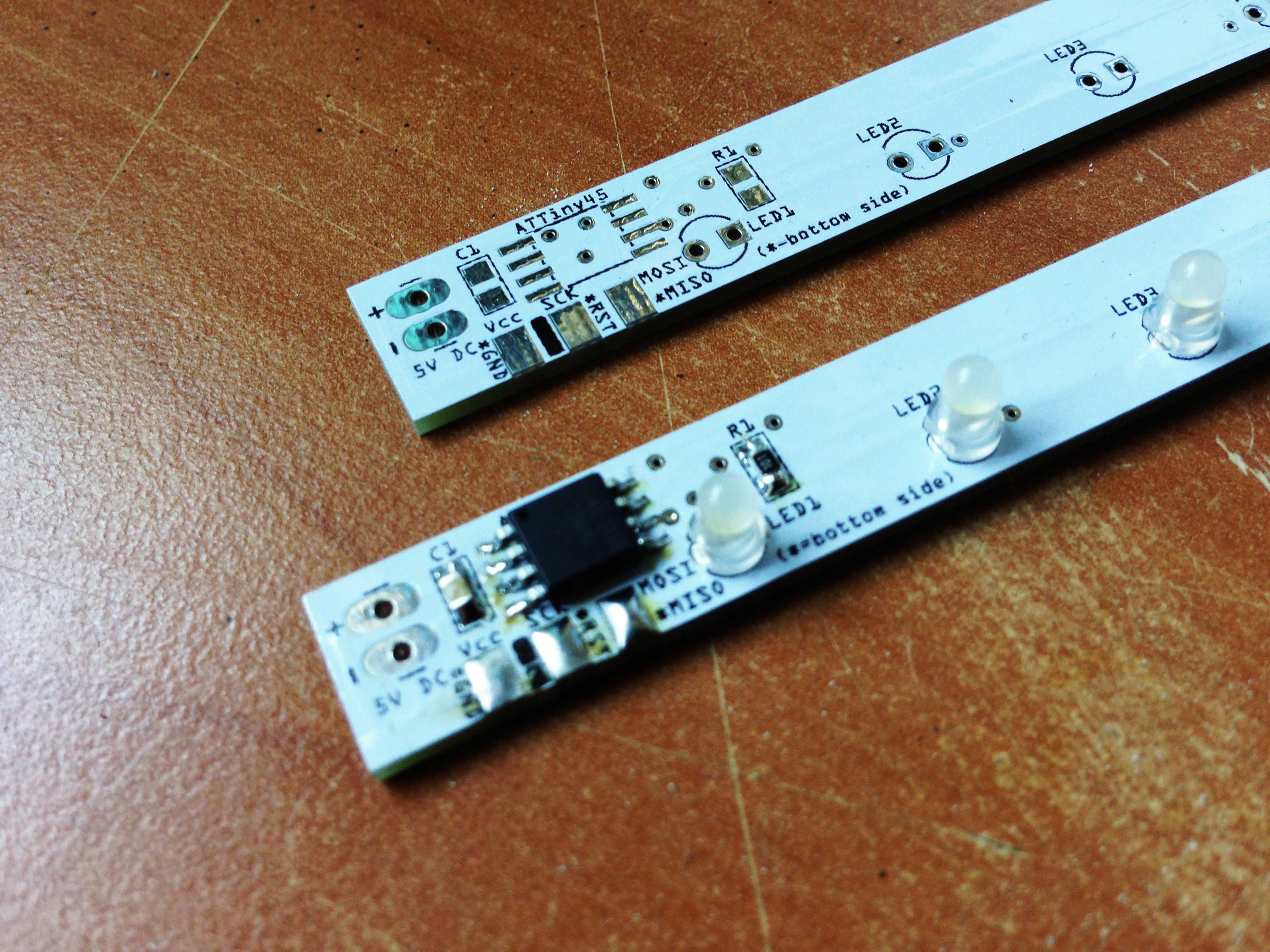

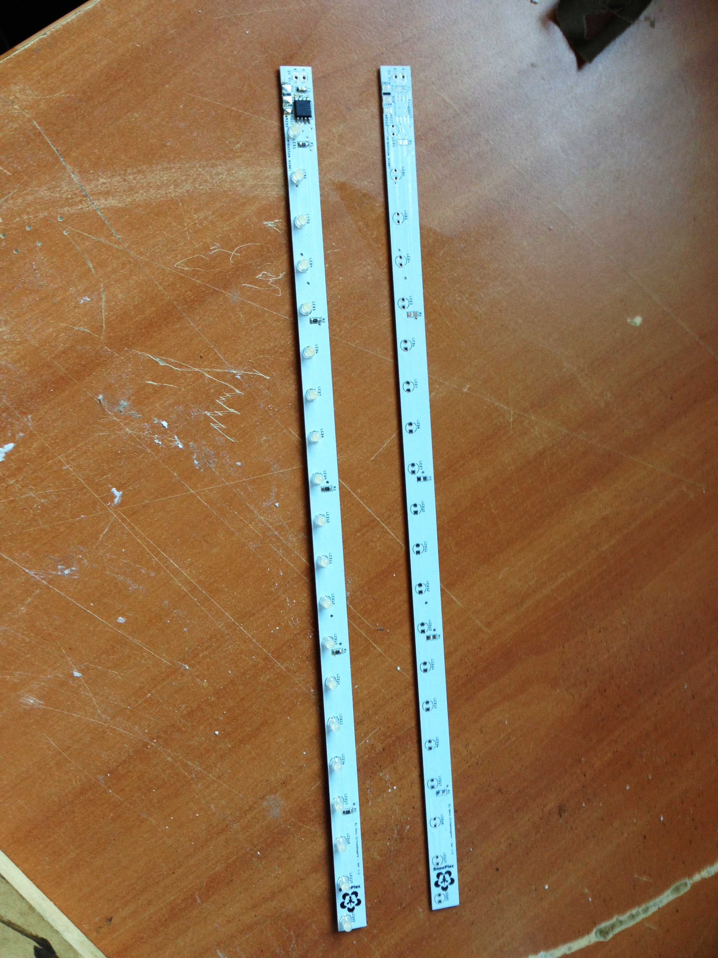

Here are mine:
Measurements: 1x29 Cm
Used components:
• 1 ATTiny 45 @ 8Mhz (SMD SOIC)
• 1 100 nF capacitor (SMD 0805)
• 5 100 Ohm restistors (SMD 0805)
• 20 diffuse cold white LEDs 3mm
I'd just took one that wasn't cleaned up...
You can see the flux around the solder.. :wink:
Here an other picture:
