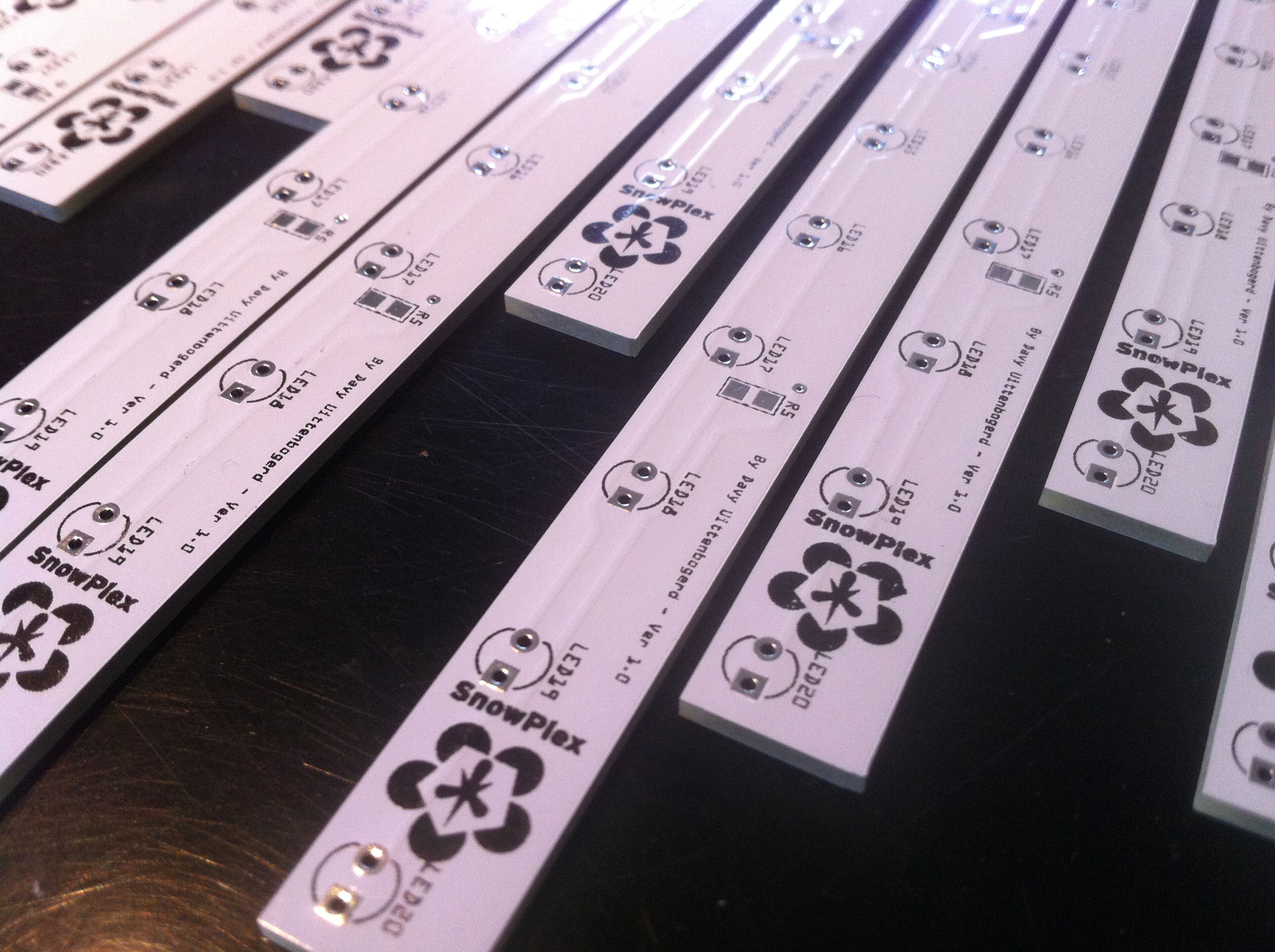

Hi Dave
Glad you've found it useful. I have put this, and my take on a Larson scanner (Knight Rider's KITT) effect using the same 20-LED charlieplex array up on github. https://github.com/strykeroz/ATTiny85-20-LED-KITT
Looking forward to seeing your next project update.
Cheers ! Geoff

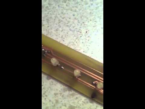

Here is the short video I took of the ones I saw
https://dl.dropbox.com/u/33809233/Movie.mp4
That effect looks awesome. Since I still had the 20 LED array set up I had a play. Here's a completely underwhelming 20 LED approximation...

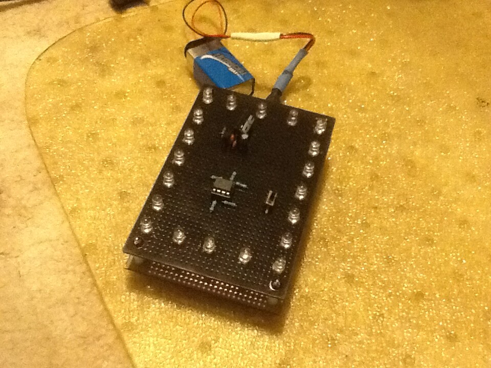

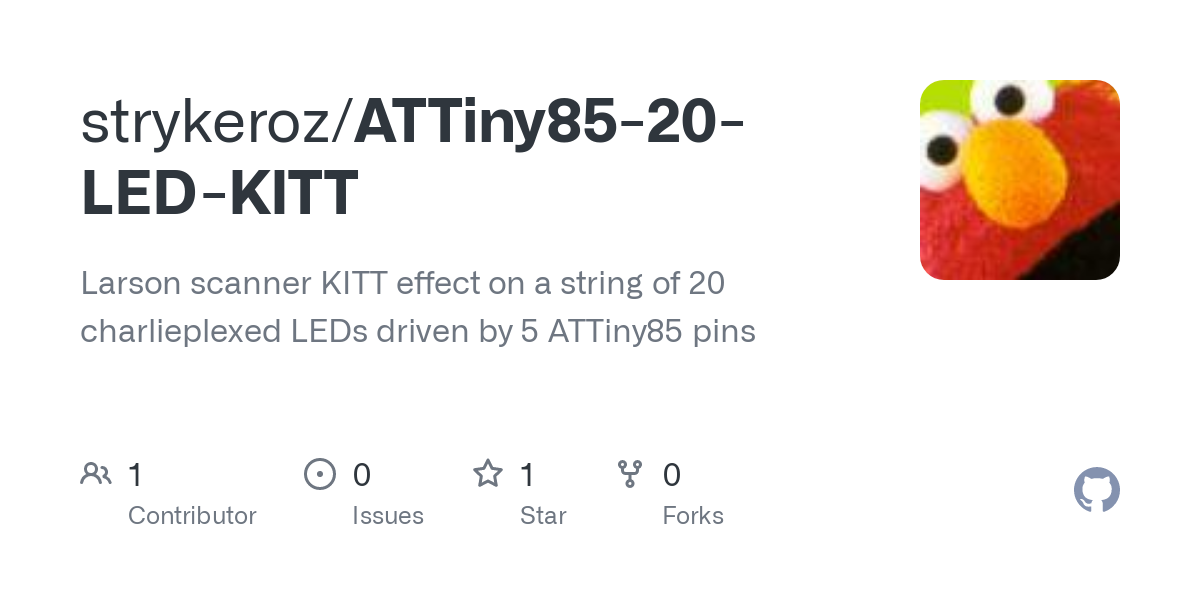

I've created a couple of these - one on a test rig and one permanently which became a KITT type Larsson scanner. To run multiple strands I'll be putting an ATTiny85 at the top of each with Vcc and GND shared across them from a wall wart. While they'll run independently, the slight randomisation in the speed and delay between falls should create a reasonable effect across the windows at the front of our house.
Measuring up the 4 windows I'll be running these in leads me to think I'll need 30 of them, so 600 white LEDs...the project is approved by the minister for finance and war so it's just a matter of sourcing the bits and dedicating the time. I'm actually very happy I have a 10 month project window on delivering this one :)
Geoff

Hello All,
I have done the prototype for the snowfall. I've made a video of it. (at the bottom) Note that I didn't trim the board to size.
I will also share the Fritzing file with all of you. It's 2 layers and this is the part list:
• 1 ATTiny 45 @ 8Mhz (SMD SOIC) • 1 100 nF capacitor (SMD 0805) • 5 100 Ohm restistors (SMD 0805) • 20 diffuse cold white LEDs 3mm • JST-2 connector (optional)
I've broken out the ISP pins to the side of the board, so you clip a programmer clip on, or just solder wires to the pads and (re)program the ATTiny.
Have fun!
Fritzing Files: Scheme: www.zwavelstokje.nl/Site/diversen/Charlie20SnowzijkantSO08-EIAJ-29cm_schema.jpg
.FZZ file: www.zwavelstokje.nl/Site/diversen/Charlie20SnowzijkantSO08-EIAJ-29cm.fzz
http://www.youtube.com/watch?v=MDtojFW7IK0

I’ve been having quite a bit of fun with this ATTiny charlieplexing. Aside from the KITT Larson scanner thing, most recently have made a little EMF detector (originally showcased here for Arduino)
With apologies for the lame iPad photo quality, here’s that one constructed, and another take on the 20 LEDs, arranged in a square which runs a sketch that loops around changing direction every 0.5 to 5sec.
Dave thanks again for the original inspiration.

The PCB’s Arrived!
I ran into some difficulties;
I made pads at the side of the board to program them as ISP. When I designed it, I didn't mention the pitch, so the ended up useless... Or I should solder 6 wires every time to each board.
So I googled and found this: http://hackaday.com/2010/11/18/build-your-own-soic-progamming-clip/
So, now I've programmed them all before I solder them. Saves me a lot of time.
Later this week I will post the pictures of the results. ;)
