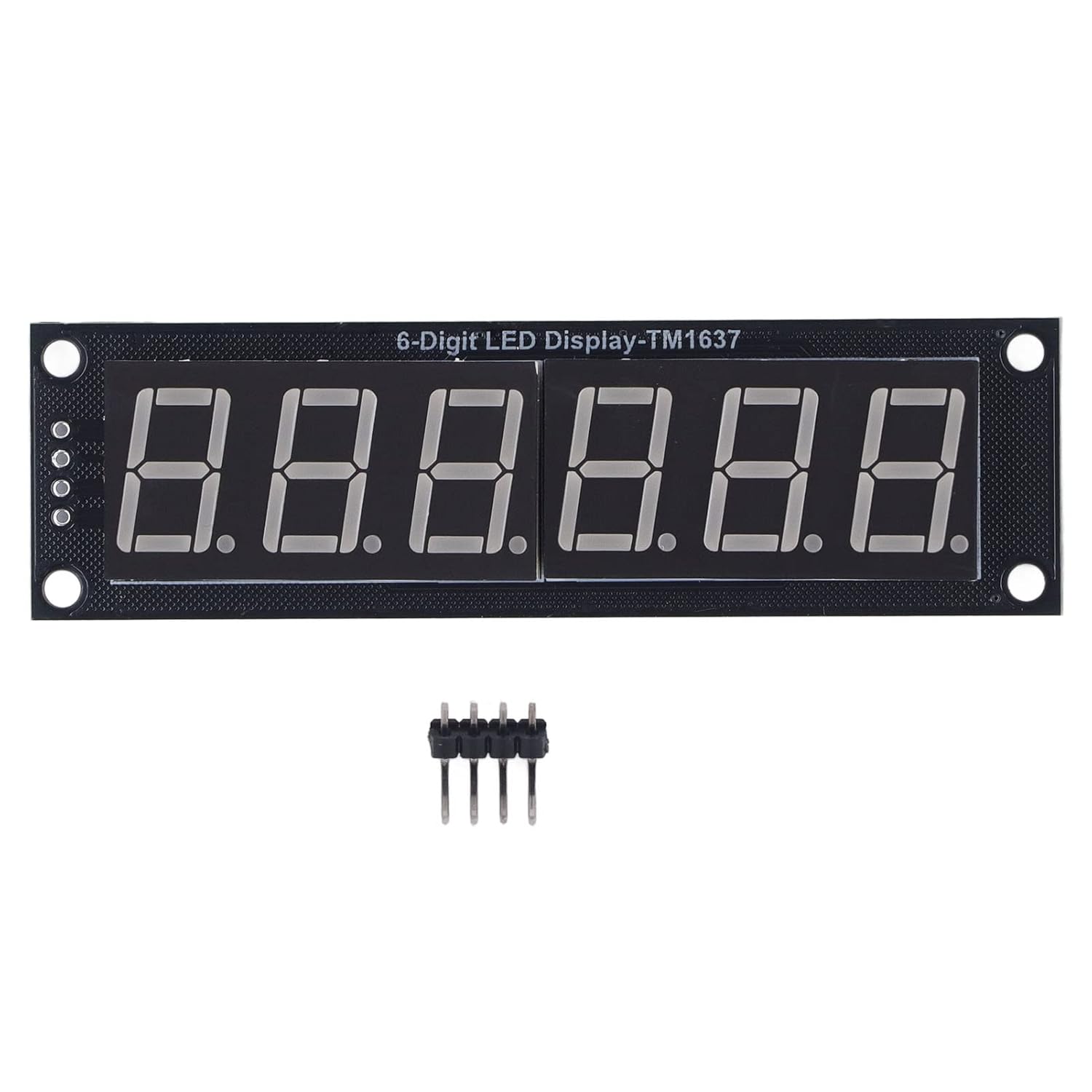

If that's a TM1637-driven display, the brain chip can drive six seven-segment displays so only two would be needed.
It's an I2C-like protocol and the IDE library manager has several options to choose from.
