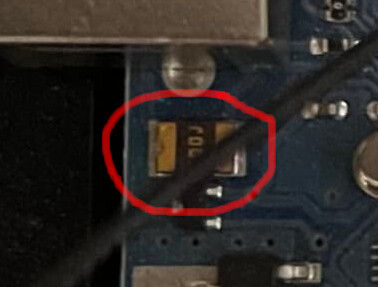

+12 VDC on Vin AND USB simultaneously?

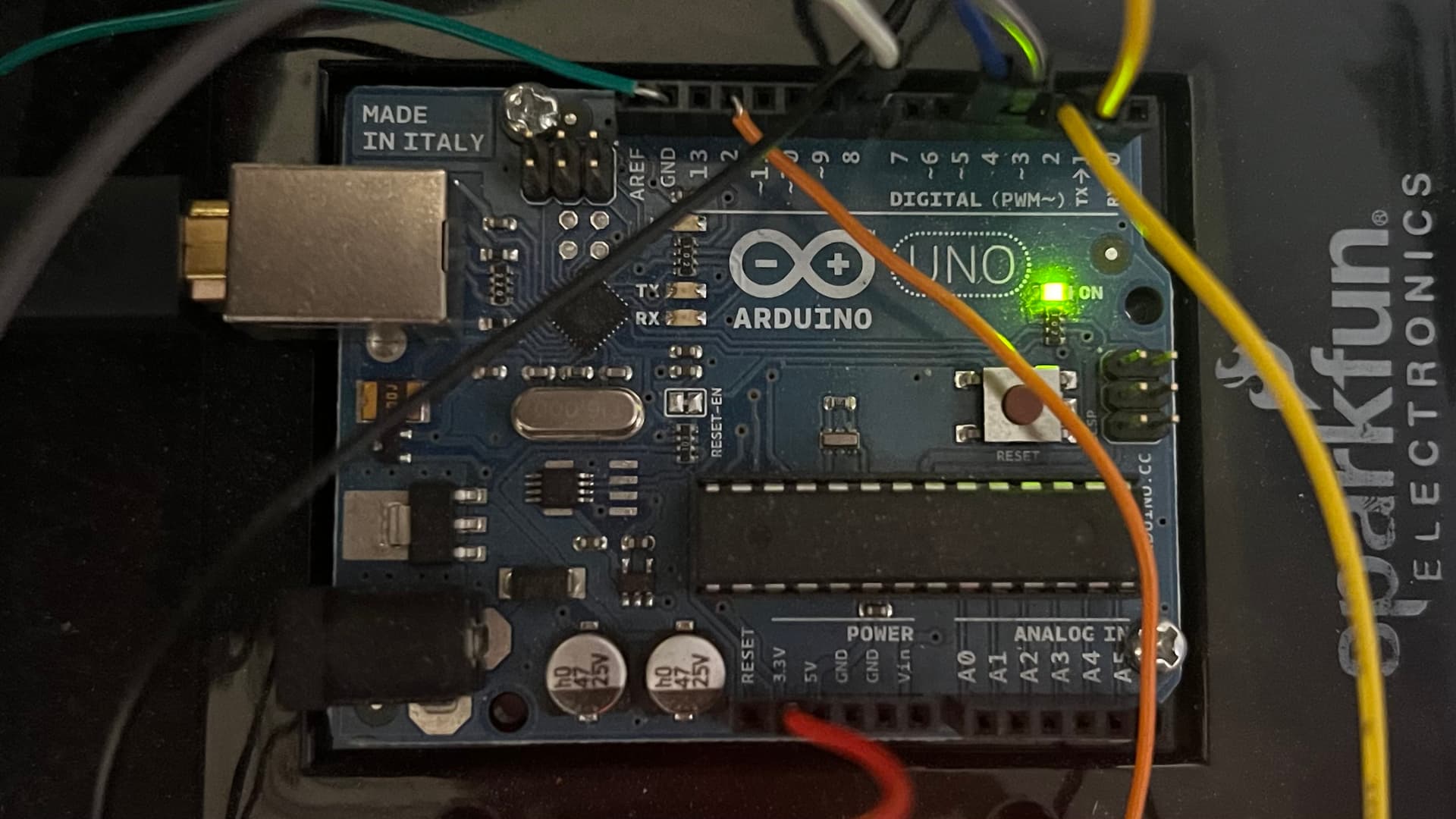

Apologies if this is an old question, but I just want to be sure I don't let the smoke out. I have an older Arduino Uno (I'm not clear on which version) that I want to power with an external +12 VDC supply via Vin while also simultaneously connecting to my mac's USB port so that I can program and make use of serial monitor.
Does the Arduino auto switch DC power between Vin and USB, or will I blow it up if both are connected at the same time?
Photo attached for reference

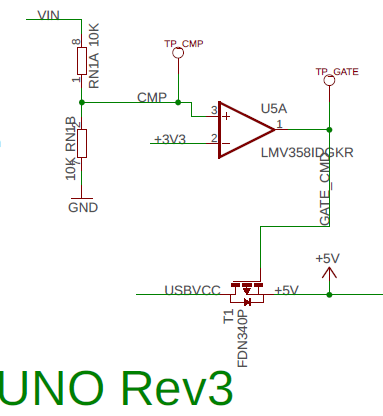

Power your Uno just from the barrel connector with nothing plugged into the USB. The measure the voltage on either end of the circled component. If you see 5V, your Uno is not shutting off the 5V path to your USB connector when it's powered externally. The 5V from your external power supply can backfeed into your USB port.
Looking at the schematic for the Uno R3, this is caused by the P channel MOSFET T1 not completely shutting off because an LM358 opamp is used for U5 rather than an LMV358. Yes, even on some real Arduino R3s. The LMV358 is a rail to rail op amp and will put 5V on T1's gate when external power is used, thereby shutting it off. The LM358 is not rail to rail, and will max out at around 3.5-3.8V — which is not enough to completely shut T1 off.

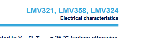

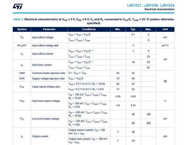

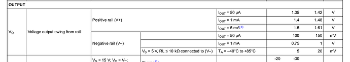

The opamp LM358 has an output swing from 0.2 to 4.8 V, the mosfet FDN340P has a threshold of (typ) 0.8 V. It switches fine.
That turns out not to be the case. I invite you to re-check the LM358 datasheet.

You have no control over whether the power comes from Vin, or the USB, unless you unplug the jack from Vin. When plugged in, the choice is made by the hardware on your Uno Rev2.
Thanks for the tip. In my case, I am bypassing the barrel connector and jumpering +12 VDC directly to the Arduino's Vin. I'll assume the voltage test is valid for either.
That's correct. The only difference using the Vin pin vs the barrel connector is bypassing the reverse polarity protection diode.
And I didn't even notice that was an R2 until @jremington mentioned it. Wow; that is an oldie!

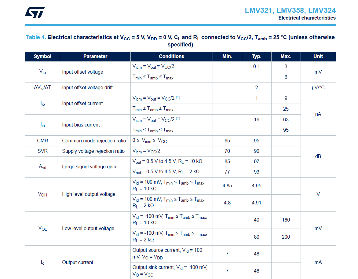

You need to lok at the right table.
And you need to look at the right datasheet.
That's the LMV358 datasheet. We're talking about the LM358 (no V). The LMV358 is rail to rail. The LM358 is not.
That is a mistake you see an many clones,
but the picture shows a genuine Uno from Italy.

Part_Schematics_UNOR3

And I have, within arm's reach, two vintage genuine Arduino Uno R3s, bought from authorized distributors back in the day, with LM358s on them. M5P marking on top, 3.5V output to the MOSFET's gate. Though if the OP is lucky, their R2 is old enough that it predates the whole LM358 instead of a LMV358 kerfuffle.
See my reply to @Wawa. Even on genuine Arduino Unos, despite what the schematics specify, the op amps are not always LMV358s.
I must agree: to separate VUSB from +5V the gate should be near the +5V, and the LM358 (without V) doesn’t do that.
