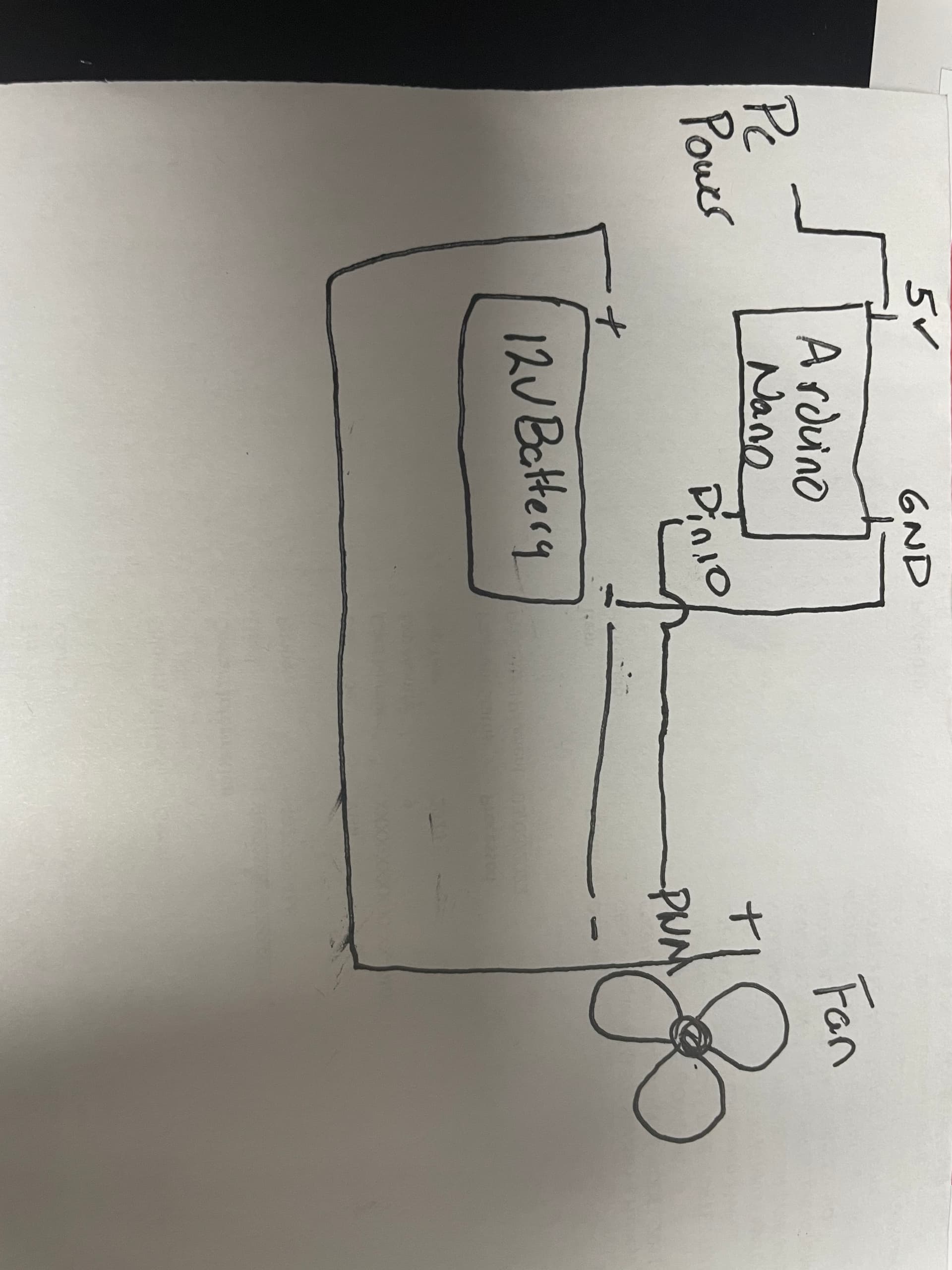

after doing more research and with the help of others I have gathered from the data sheet how the fan is to be controlled on the PWM input pin. The circuit structure to drive the pin PWM / E can be any active low “open collector” Typical circuitry In this operating mode the supply voltage plus is usually connected permanently. To run the Drive on the pin PWM* / E* a PWM signal has to be applied and with the duty cycle of the PWM signal the Drive speed can be then controlled **
I have also connected the fans positive and negative to the battery supply voltage(12.5V) and got the same voltage out of the fans PWM*/E* pin. From the help of others on the Arduino forum I have been informed this is confirmation that the fan is controlled by an open collector circuit.
I am currently trying to generate a 128hz PWM 5V signal to command a brushless cooling fan for a car, I will upload my very basic code, the library used, and a schematic from desktop. Currently I am not able to command the fan to turn on and am just curious mainly if maybe what I am trying to do is not possible or if I am just making an error somewhere
using arduino nano

#include <PWM.h>
int duty = 128;
pinMode(10, OUTPUT);
SetPinFrequency(10, 128);
pwmWrite(10, duty);
pwmWrite(10,duty);

Could You please post schematics for Your setup.
That's not what your code does. Your code does a 500 or 1000Hz (depending on the pin used) 50% duty cycle signal, if and ONLY if you're using a pin that has pwm capability.
You're confusing duty cycle and frequency. They're different things.
Also don't assume your fan reliably spins up at any given frequency and duty cycle. It won't. You'll have to experimentally determine for each given pwm frequency what the reliable spin up rate is and how low you can dial the dury cycle back (once it's alresdy spinning) for it to keep turning. The latter will be a much lower number than the former.
You CAN modify the pwm frequency on an arduino and just about any microcontroller.
So I was misunderstanding the function of this library, I thought I was able to modify the frequency and duty cycle. do you happen to know of any easy to use libraries that will accomplish my goals ?
Never looked into it to be honest, but I would suspect so. I would just manipulate the clock divider register for the timer used; it's just one line of code, but takes some studying to understand what you're doing. I'm sure someone has already written something to make this more user friendly.

Since it is an automotive controller, perhaps it wants a high/low pwm input of 12/0 V instead of 5/0.
The linked data sheet is not clear to me.
yes unfortunately SPAl does not have a great data sheet, I will reach out now to their support line to see if I can find out if its expecting 12v or 5v for the pwm signal.
It's probably easier to measure it on the engine. Really, you should discover and verify all the parameters this way.
But from the data sheet,
the circuit structure to drive the pin PWM* / E* can be any active low “open collector” Typical
circuit
...and I bet that in spite of that, the support people will not know. :slight_smile:
it was my understanding that the fan was looking for 5V 128Hz pwm 5-95% duty on that PWM*/E* pin, I just reached out to SPAL to verify what voltage and frequency the controller is expecting.
from what source? The data sheet contradicts that. It says nothing about frequency, though... there is no voltage spec, because it's an open collector drive.
this fan is a direct replacement for a General Motor fan and is supposed to be plug and play with the pwm signal from the engine controller, I looked at the data sheet for 2016 corvette cooling fan control and 5V 128Hz pwm 5-95% duty is what I found.
Yes, but is that a typical value, max or min is not specified? Just because 128Hz happens to work doesn't mean it's the only frequency that will work.
Obviously the Corvette data is wrong, or else they are using the analog speed control instead.
Please post the Corvette sheet if you have it in electronic form.
You can not connect a 5V digital output to an open collector input unless it's pulled up internally to 5V.
Also if you do, you run the risk of phantom powering the driving source.
so after reading the SPAL data sheet again I see where it says any open collector, when driven low it will command the fan to full speed. I am trying to use the Arduino in place of the corvette engine control module PWM signal. I am working now to get an oscilloscope to read the signal the Arduino is generating. I also reached out to SPAL for more information about frequency voltage and duty cycle range.
Why, when that is fully documented and understood? I think, unless you phrase your question about voltage to the support staff very carefully, you won't get a definitive answer. It's easier to go measure it. Look at the voltage on the PWM in pin with power applied to the fan.
I am getting ~12.5V ( same as battery supply voltage) from the PWM*/E* wire while the fan is connected to power.
