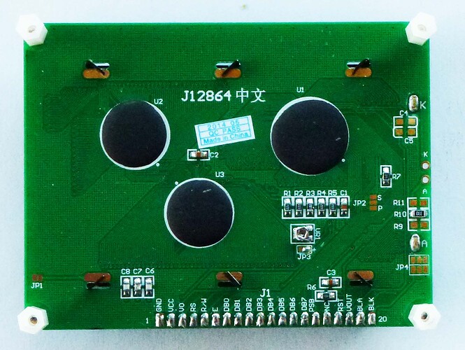

The correct pinout for my 128x64 GLCD which carries the only identifying feature of J12864 followed by two chinese characters is:
Pin 1 - GND; Pin 2 - Vcc; Pin 3 - Vo; Pin 4 - RS; Pin 5 - R/W; Pin 6 - E; Pin 7 to Pin 14 - DB0 to DB7; Pin 15 - PSB (Parallel-H/serial-L select); Pin 16 - NC; Pin - 17 RST; Pin 18 - Vout; (from internal voltage doubler); BLA (Backlight annode); Pin 20 - BLK (Cathode).

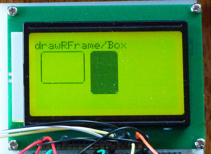

U8glib should work for this display controller (see also my picture below)
For serial setup, connect PSB with GND. Then connect E, RW, RS and RST with some GPIO ports of your board and remember the Arduino pin numbers. Once you installed U8glib, use the following constructor:
U8GLIB_ST7920_128X64_1X(E, RW, RS, RST)
with E, RW, RS and RST must be the pin numbers of your Arduino board.
Similar to a KS0108 setup, V0 has to go to the wiper of a variable resistor, which is connected between GND and Vout for contrast adjustment. On the picture below, i placed the var port directly on the display module.

Thanks once again Oliver – and this time SUCCESS using your U8glib code!
I have attached 3 pictures showing the GLCD working, the Arduino Uno wiring and have included the description of what I did to achieve this for anyone who might be interested in using the 128x64 GLCD! This monochrome display is an excellent GLCD and shows very crisp alpha-numeric characters. The graphics capability is also quite good. It was very cheap at Aus. $10!
The Code:
I used U8GLIB_ST7920_128X64_1X u8g(E, RW, RS, RST); and using the Arduino Uno pins as shown here; U8GLIB_ST7920_128X64_1X u8g(13, 11, 10); RST GLCD pin 17 was not used as the GLCD worked whether or not RST was connected. I am not sure whether not connecting the RST has any adverse consequences. The one adverse observation noted with this particular code is that it takes a very long time for this code to compile and to upload! Could not connecting the RST be causing this slowness?
Uno Wiring:
Parallel/serial select PSB GLCD pin 15 was connected to GND bus, which sets the display in serial mode.
Arduino Uno +5V connected to breadboard bus; GND connected to breadboard –ve bus.
In my case I used a single 220 ohm resistor connected from +5 bus through the resistor to GLCD pin 19, BLA just to be safe and protect the GLCD backlights, and –ve bus to BLK.
I also used a 10K pot as follows; one leg of the pot connected to +5V and the other to GND while the wiper was connected to GLCD Vo pin 3 – the GLCD contrast control. (See below for additional comments on display contrast control).
GLCD GND pin 1 was connected to –ve (GND) bus and GLCD Vcc pin 2 was connected to +5V.
And that’s it!!!

The third picture shows the components on the rear of the display. Of special interest is VR1; a 7.2K variable pot shown as the “screw” beneath the R1-R5 header. I believe this pot is a built in display contrast control but as stated in my previous post I have not been able to obtain the Datasheet for this GLCD and have only thus far obtained the ST7920 Controller DS. Below VR1 is jumper pad JP3 which itself is not bridged across this jumper pad. Jumper pad 3 connects with VR1 and is, I believe, the means of switching VR1 into or out of the circuit.
Since I have not obtained the GLCD datasheet I am not sure whether VR1 is presently activated so if anyone knows how VR1 (and I am not game enough to just try it without knowing what it does) and JP3 are operated I would be very grateful to know this. I would be equally interested to learn what R1-R7, R10 and JP1, JP2 and JP4 are controlling?
