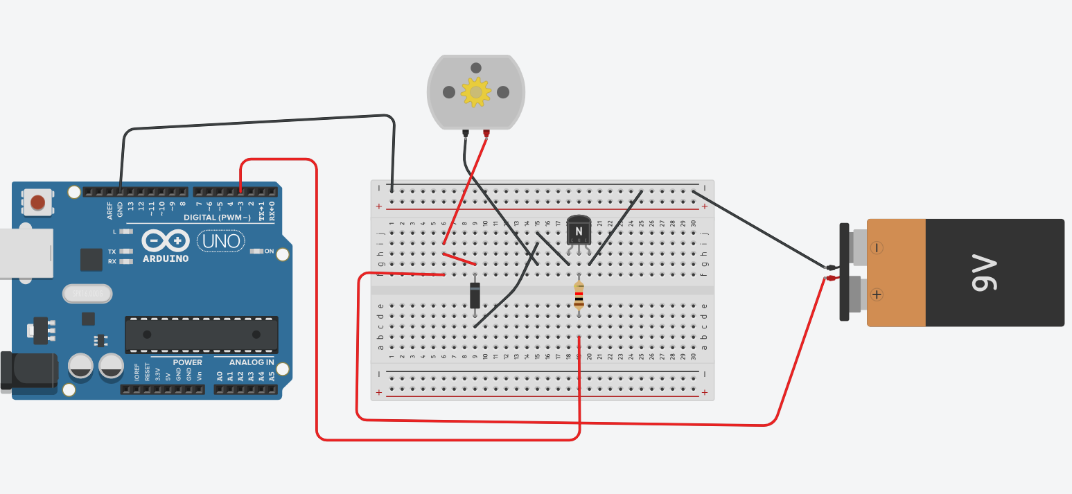

Hey, I want to drive a 12V DC 2-wire 0.47A blower fan. As it only has 2 wires, I thought of controlling the fan speed via the voltage I provide it. I want to control the voltage through a PWM signal from an Arduino uno.
I have created the following circuit in tinkercad, just to see if my circuit makes sense or not. The battery in my schematic is 9V (instead of a 12V battery) and I put a motor as a placeholder (instead of a 12V 2-wire fan).
First of all, is my circuit correct in general?
Secondly, how do I go about choosing the appropriate components for the circuit?
What would be an appropriate resistor value in front of the base of the transistor?
What transistor should I use?
What zener diode should I use as a flyback diode? (or is there a better alternative?)
Thanks in advance! If anything is unclear, please ask questions!
There are no connections to the collector or emitter.
There should be, they are hiding behind the transistor, maybe it a bit unclear
maybe this is a bit more clear
Very unclear, maybe they could be backwards, I would never know.
Much better

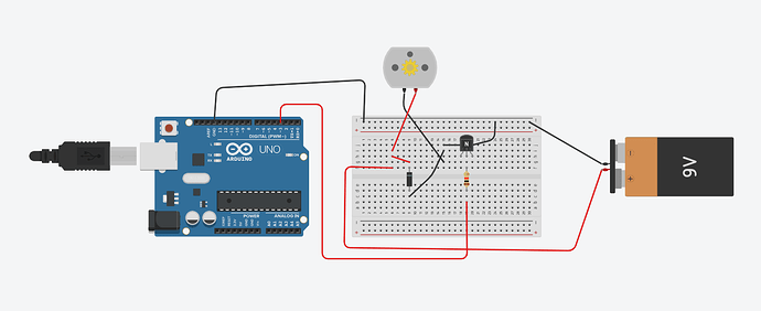

Do you think the following would also work:
Logic Level N-Channel Mosfet such as an IRLZ44
22 Ohm resistor for RG
1N5419 diode flyback
slightly adapted circuit, as i learned that an extra resistor might help avoid accidentally switching on the transistor for example when the arduino starts
RG should be 330
The 1N5419 cost about $8 (USD) a 1N4007 is much cheaper.
The 10K resistor should be connected to the left of RG
NMOS can be IRLZ44N
