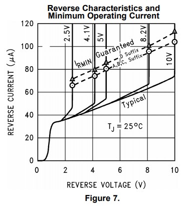

For LM4040 the following ranges can be used:
2.048 V +/- 0.1%
2.5 V +/- 0.1%
3.0 V +/- 0.1%
4.096 V +/- 0.1%
I preferred 2.048 V version, because it give better resolution after ADC.

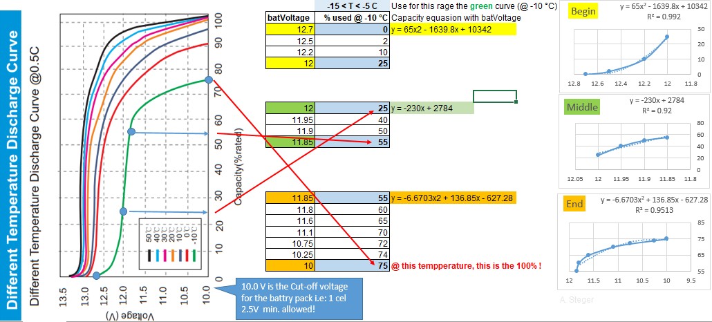

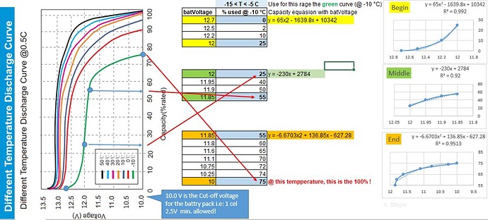

After so many improvements, I would like to involve the temperature in the battery capacity (percentage) calculation.
For case study with LiFePO4 battery, I selected this source: link and the attached picture (discharge).
-> If Your have better source, like with numbers/ (%&Volt) data, which generating the graph itself, then kindly share with us, because those data can be used for non-linear regression. (Instead of manually figure out the points from the below graph.)

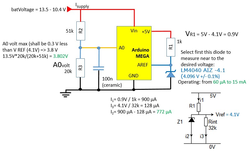

So my external reference shall be as high as possible, because I already would like to measure more than 5V.
I selected your proposal :slight_smile: LM4040 AIZ -4.1V
The voltage on the divider shall be approx 0.3V less. (because the 4.1V will be the '100%')
So it will come: 3.8V. I changed the resistors accordingly. (20k & 51k receptively.)
The diode will get the supply form +5V out from MAEGA. (Not from 12V.)
For this, I have to select R1 protection resistor accordingly, so min.60 μA, max. 15 mA can flow through the diode.
I attached the modified schematics. I hope it is fine.

check the voltage from the arduino - you do need 5V.
I'm not sure what your numbers below the yellow box are for - you say choose R1 = 4.3k,
then use
5.0 - 4.1 / 1.0k = 209uA which a: is wrong and b: is not 4k3
4k3 doesnt leave much headroom if the "5V" drops.
You would need to re-plot the data to give voltage vs temperature for different capacities.
Soryyou need to take sopt readings from the graph to get your information, a bit tedious but useful
@ johnerrington: Thank You to pointing put the calculation error and further improvement points..
I intended to use R1= 1k ohm, but somehow I made typing mistake.
However for review, I attached the corrected schematic & full script:

Now I would like to continue with the temperature dependency of the capacity of the battery.
My approach:
The battery discharge curve depending on a lot of parameters (temperature, chemistry, charge & discharge rates etc.)
The most significant from my point of view is the temperature, which can be relatively easily and accurately measured and involved in capacity calculation.
So first of all to everybody, who will follow the next steps and get accurate results, they have to have the discharge curves for they own battery and correct the figures accordingly to avoid any additional error.
Take a curve @ specific temperature, split in three or more sections. Take the values manually and fetch in tables.
Do the regression (insert trend line) with a software (Excel etc.) and make the equation for the curve visible on the graph.
Hard-code the ranges and equation in the script. Measure the temperature and pass it in the function.
Somehow as I attached.

 // *** NEW section start ****************************
  batVoltage = batVoltage / 1000; // I converted mV to V for better understanding, but You can use mV as well.
  if (temp >-15 && temp <= -5) // -10 Celsius (green) curve
	if (batVoltage < 12.7 && batVoltage >=12.0) percentage = -65*batVoltage*batVoltage - 1639.8*batVoltage + 10342;
    if (batVoltage < 12.0 && batVoltage >=11.85) percentage = -230*batVoltage + 2784 ;
	if (batVoltage < 11.85 && batVoltage >=10.0) percentage = -6.6703*batVoltage*batVoltage + 136.85*batVoltage - 627.28 ;
	percentage = 100* (75 - percentage)/75;   // as per graph @75% the battery fully depleted ! So 75% will be equvivalent to 100%

Improvement: Take the data from graph only in mV and not in V.
In this case divider required (1000 0000 & 1000) in the 'percentage' equation accordingly.
So this:
if (batVoltage < 12.7 //comparing an unsigned it to a float?
Can become like this:
if (batVoltage < 12700
I don't understand fully:
All that if ..else is a clear contender to be written as a switch - case structure
This can be made for 'batVoltage' but not for 'temp', due to the value must be integer:
  switch ( batVoltage )  {
    case 12000 ... 12700:
       percentage = -65 * batVoltage * batVoltage / 1000000 - 1639.8 * batVoltage / 1000 + 10342;
    case 11850 ... 11999:
       percentage = -230 * batVoltage / 1000 + 2784;
    case 10000 ... 11849:
       percentage = -6.6703 * batVoltage * batVoltage / 1000000 + 136.85 * batVoltage / 1000 - 627.28;
    default:
       percentage = 999;   //wrong 'batVoltage' value
   }  // end switch
There must be a way to do this in math, not piecewise. Capacity is a function of terminal voltage and temperature, so there must BE an equation C = (fv, ft)
However, have you spotted that the terminal voltage is ALSO very significantly a function of load current?
The graph you are using is for a discharge current of 0.5C - which for the 32Ah battery is 16A.
Your calculations will only be valid at all if that current is being drawn.
As for a rover the load current will be constantly changing you cant calculate the remaining capacity unless you can correct for the load current, and it gets more complicated.
MAYBE you could use the open-circuit terminal voltage and temperature to get an estimate - but dont forget a battery terminal voltage doesnt recover instantaneously when the load is removed, so it would need to be open circuit for a little while, not just a second.

const unsigned long BatRs[] = {51028, 19979};    // R2 & R3 in ohm, must be measured accurately !!!
const unsigned long InverseVoltDividerRatio = ((BatRs[0] + BatRs[1]) / BatRs[1];

  analogReference(EXTERNAL);
  adcValue = averageRead(BatVoltPin);
  voltageOnPinA0 = 4 * adcValue; // mV; 4096 / 1024 =4
  unsigned int batVoltage = InverseVoltDividerRatio * voltageOnPinA0;  // mV; 20k & 51k resistors on voltage divider.
	switch(batVoltage){
		case 12000 .. 12700:
            percentage = percentage = -65*batVoltage*batVoltage/1000000 - 1639.8*batVoltage/1000 + 10342;
		case 11850 .. 11999:
            percentage = percentage = percentage = -230*batVoltage/1000 + 2784;
		case 10000 .. 11849:
            percentage = -6.6703*batVoltage*batVoltage/1000000 + 136.85*batVoltage/1000 - 627.28;
		default:
            percentage = 999;   //wrong value
