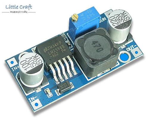

Currently Im using a DC step down module to go from 12-14.5v down to 5v to the 5V pin on my Nano but Im wondering what the most efficient way to configure this is?
Switching DC-DC converters tend to be very efficient (you can get more than 90% efficiency* and more current-out than goes-in).
With a linear voltage regulator the current-in is the same as the current-out, and with 7V dropped across the voltage regulator and 5V across the load, more power is wasted in the regulator than is getting to the load.

What I'm using is this
Hmm... It's does show power draw but just no body is home on the ardunio.

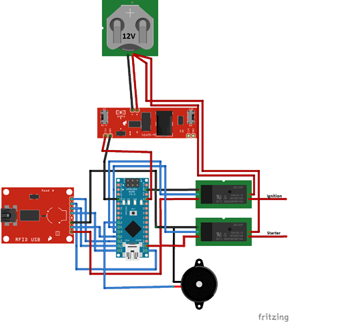

Here is the schematic. Note that the "power supply" in this schematic is a DC-DC Step down module.
I'm also considering adding in 1 or 2 x 18650 batteries to power it when the bike is switched off but I'm not quite sure how to do this yet... Any suggestion? Ideally it would charge when the bike is on and run from it when the bike is off.
I see RFID, do you put that thing into some sort of sleep? Otherwise all you're efforts will be pointless.
And if you want to permanently use the device, don't go out of spec. And I think 16Mhz but in sleep is just fine for a motorcycle.
And why on earth would you add 18650???!!! You have a 12V battery in that thing. Just use that ::slight_smile:
