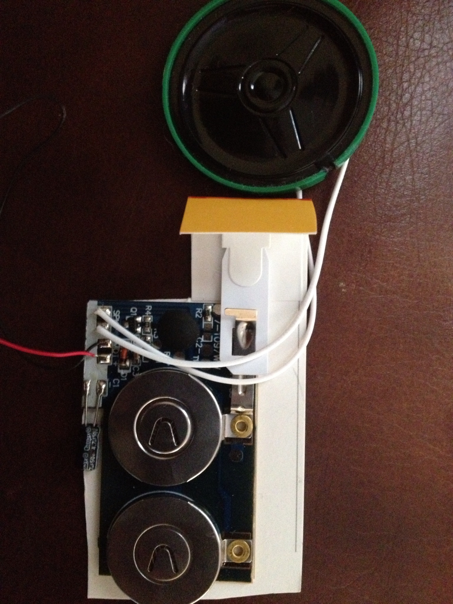

So I got a sweet Batman Birthday card that plays a short clip of the Bat Theme when I open it. Then I cut the card open with my knife cause I wanted to see how they did it. So my question is I want to make something like this that has a simple trigger that will play one sound when the switch is opened, but so far the only thing I've seen is I have to buy a MEGA attached to a MP3 Shield etc and $150 later I have the same thing that this $5 card came with.
Is there a simpler cheaper way to do this?

Hi DBL07,
Happy birthday!
Look at the switch on the card. If you can take it apart and solder a wire to the 2 leads, you can control it with your Arduino. Most likely, it is a ground closure switch (test that by grounding one of the leads to see if it makes it play, if not, try the other one),
Then connect the card's ground to the Arduino ground and connect the switch control lead to GPIO pin of your choice. Set it up as an output (HIGH). Then write a FALSE/LOW to it to trigger the sound.
Pat.
PS, but you have to admire robtillaart's response!
I would be VERY Careful of that method as the card electronics isn't likely 5 V tolerant.
One 'suggestion' might be to use a diode cathode pointing to the card and anode pointing to the Arduino.
a "Plain" 1N5818 schottky diode because the diode only has a .4V drop instead of the 'normal' silicon diodes .6V drop.
Bob
Hmmmm, that's true. The sound card I hacked was ok, but I'm not sure what powers a Bday card.
DBL, do you have a voltmeter to check?

I reckon you could do it with an Attiny85 and the PWM Audio library, modified to play the tune direct from progmem instead of an SD card. See http://arduino.cc/forum/index.php/topic,112745.0.html.
I made a little program that plays happy birthday a while back. Maybe not you want, and the notes and durations are not yet perfect, but it should not take too long to figure that out.

I mean, how can I build something like this from scratch to play my theme song 007 in a loop without spending 150 on the whole rig $) Thanks for all your replies btw!

How determined are you NOT to buy the cheap working solution? I'm sure you can buy these devices ready to be programmed, and since they include them in gift cards the hardware must be very cheap. You can develop your own equivalent on an Arduino, or a PC, or a mainframe, or whatever hardware takes your fancy, but you're back to how much time and money you're willing to invest in it. All you need is an Arduino and an MP3 shield and a switch. Or a dictaphone and a switch. Or a fifty cent gadget out of a gift card and a switch.
