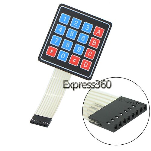

16-KEY matrix KEYPAD using 74c922 16-key encoder ic
This is a 16-key matrix keypad project using the 74c922 16-key encoder ic (circa 1995) .
The wiring is straightforward.
The 74c922 datasheet shows the Truth Table on pg-4 and the layout and wiring on pgs. 6 & 7.
Rows 1 ,2,3 & 4 are ic pins -1,2,3 & 4 respectively.
Columns 1,2,3 & 4 are ic pins -11, 10,8, & 7 respectively.
OSC cap is 0.01 uF on pin-5 of ic.
KeyBounce Mask (KBM) (debounce cap) is 0.1 uF on ic pin-6.
Vcc is pin 18.
Gnd is pin-9
DATA_AV (Data Available) is ic pin-12 and goes to Arduino INT0 input on pin-2.
OE-NOT (Output Enable) is ic pin 13. (not used because if left unconnected the ic outputs are always available)

Attached :
A terminal capture of the serial output showing the binary code read and the Key mapped to that value by the ARRAY.
The IDE source code program "*.ino" file.
A photo of the 16-key keypad used.
A WORD file with the keypad MAPPING info.
ClearTerminal_Capture__16_KEY_KEYPAD_.txt (906 Bytes)
Matrix_4x3_12_key_keypad_to_74c922_encoder_ic_ISR_PORTB_INT0.ino (938 Bytes)
KEYPAD MAPPING.docx (13.4 KB)
In case it isn't obvious, the "A",B,C & D keys were mapped to those HEXADECIMAL VALUES (10,11,12,& 13)
Since there was no "E" or "F" keys, the " * " (asterisk) was mapped to value 14 DEC and the
" # " (pound) key was mapped to the value "15" to provide a full 16 HEXADECIMAL output code range.
FYI, The program filename still has 4x3 Matrix. That should have been changed to 4x4.
Here's the keypad datasheet
matrix_4x4_keypad datasheet.pdf (116 KB)
