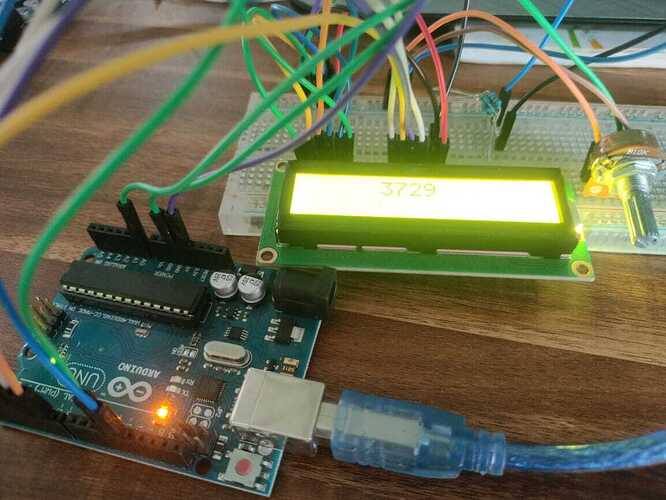

16x2 LCD displaying 0 - 9999 values using Potentiometer with Arduino UNO
Hi, I'm quite new to Arduino and Iam making 16x2 LCD using autoscroll function because values range 0-9999 from potentiometer and contrast adjust to digital pin 6 , pot pin connected to A0 and setcursor also used in lcd but unwanted characters generated like 3cS# and also im displayed in 156 serial monitor but in lcd 1560 generated and adjusting pot values slowly generated in lcd and I'm setting cursor (5,0) but sometime values displayed in (0,0).
code:

I don't understand, you use autoscroll because what ?

Since analogRead(A0) returns a value between 0 and 1023, could you please explain why your sketch then tries to map the returned value from [0..9999] to [0..1023]? I have pondered that piece of code at length and I find it puzzling.

I want to display 0 - 9999 values in lcd to adjust the pot , I know pot A0 values range from 0 to 1023 but I want to display 0 - 9999 both serial monitor and lcd
if you want to see your mapped values, you need to use the variable which contains the mapped values

You will not be able to display every value in the range, because that is 10,000 different values and the pot gives only 1,000 values.
You could add a second pot. One pot can be "coarse" and the other "fine":

You need a 16 bit ADC like ADS1115 that will give values greater than 10,000.
int potData = map(potPin, 0, maxADCvalue, 0, 9999);
what is the value for maxADCValue , please explain
Consider the 16 bit ADS1115, it's aref voltage is 6.144V, if you put 0 ~ 5V on it's input it will return a value of 0 ~ ( 5 / 6.144 * 32767) = 26664.
So, maxADCvalue would be the value read when 5V is applied to the input.
9999 / 26664 = 0.375. So if you put 5V on the input you would have 26664 returned, multiplied by 3 / 8 would print 9999.
