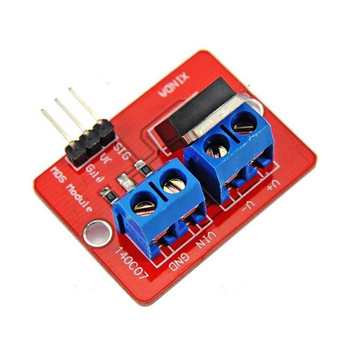

I ordered a few of these ready-to-use Boards with an IRF520 on it —>
They should easily handle their task :smiley:

the IRF520 is not even on the chart until you get to 4.5V

But I can safely say that the IRF520 modules do their job perfectly. I was able to do a test run yesterday and the transistors didn't even get hand-warm. That means for me that Vgs is sufficiently and therefore absolutely suitable.
