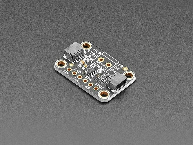

To get a pure sine wave you need an Arduino with a DAC, running sine wave synthesis code, and probably, some low pass filtering on the output to remove the residual harmonics.

Thanks for the info, i will search around for a dac and how to make a low pass filter.

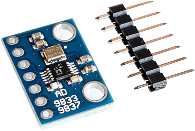

You can generate a wide range of sinewave frequencies using an AD9833 DDS module.
AD9833 Module

I added it, thanks.

The module shown in post #14 looks promising as well.
