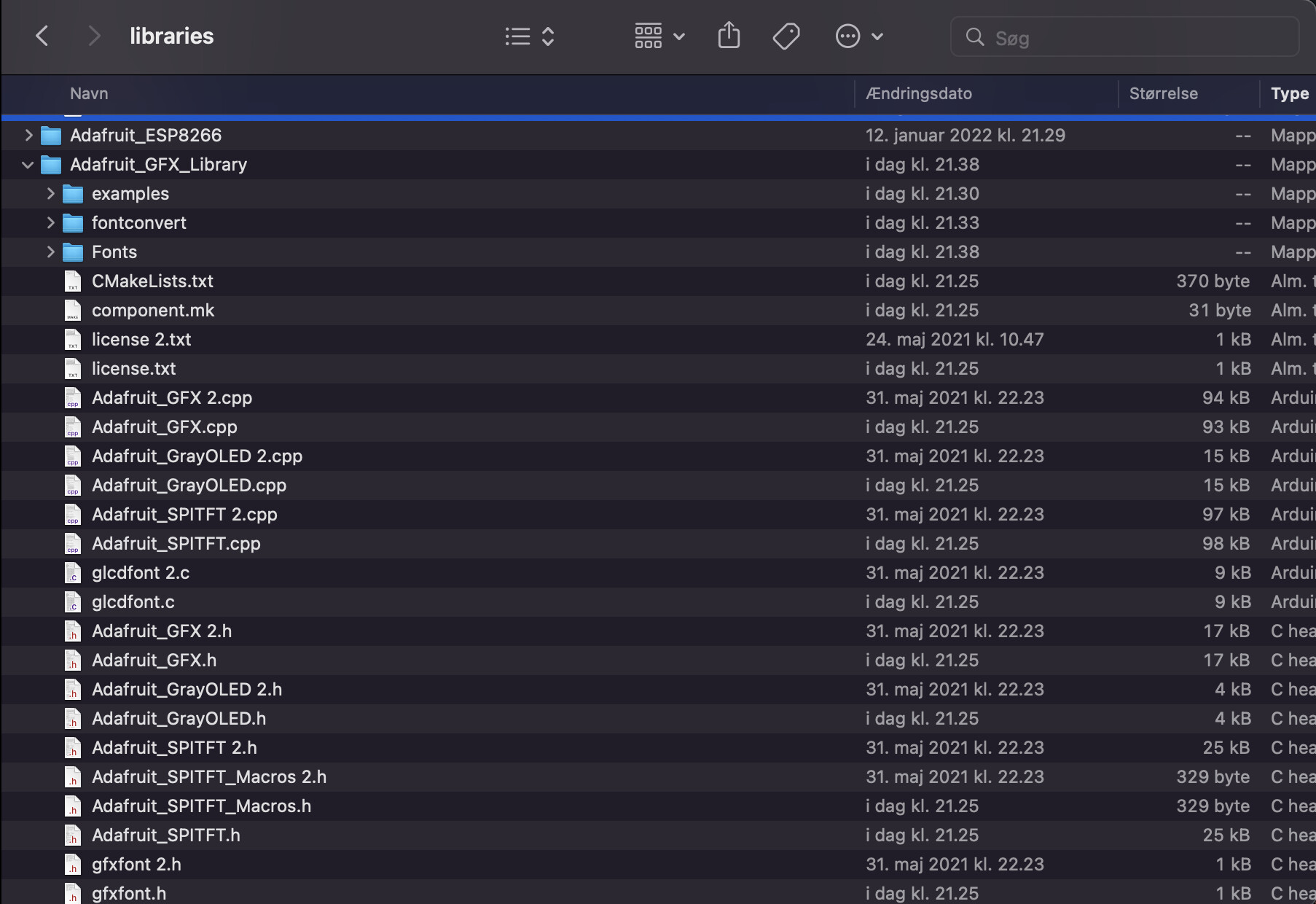

Yes, I think you are right, that make sense. I guess I learned not to have such files as fonts stored inside a folder, which are used to store a library. I this case I have stored my fonts in a library folder called Adafruit_GFX_Library.
By further investigating, it turns out, that all files (approx 4.500) has now been copied and added " 2" (space&2) at the end. That is not super convenient and I think that this is actually the issue messing with my compiling.
This is the error code I get from the fine IDE:
/Users/masslyngby/Documents/Arduino/libraries/Adafruit_BusIO/Adafruit_SPIDevice 2.cpp:16:40: error: 'BitOrder' has not been declared

You are probably already aware, but for the sake of others who may read this thread I should make it clear that the IDE never updates libraries without the consent of the user. The user has full control over the updates. The IDE will automatically check for newer versions of the installed libraries and offer to install them, but the update is only done if the user clicks a button telling the IDE to do it.
I don't know how to explain that. As b707 said, all the files in a library are replaced when it is updated. That is how it has always been, even in Arduino IDE 1.x. For this reason, any added files or modifications would need to be replaced manually after each update of a library. If you are going to do that, it is wise to back up your modifications in a safe location outside the libraries folder to make sure they will never be lost through an update.
On some rare occasions, the Arduino IDE 1.x Library Manager did install the new version of a library to a folder with a random name like arduino_34534 instead of replacing the previous library during the update. This might happen if the IDE was blocked from accomplishing that final replacement step by the antivirus or by a lock on the original library folder due to another application having it open. That is the only case I can think of where an update would not result in the loss of files added by the user to the library.
There was one previous report of a library update causing this problem where all the library's previous files were left behind, with this " 2" suffix added to the file names:
Since this would usually cause any sketch using the library to no longer compile, with perplexing errors, it is likely affected users would post here on the forum or submit a bug report on GitHub and I have not seen any other reports in either place. So it seems to only occur very rarely.
I am not experienced with macOS, but I asked a colleague who is about this and they suspect it is caused by iCloud. They have not been able to reproduce the problem though.
I am definitely keeping an eye out for reports of this problem, but it will be difficult to do any investigation without a better understanding of it. Please let us know if you learn anything more.
