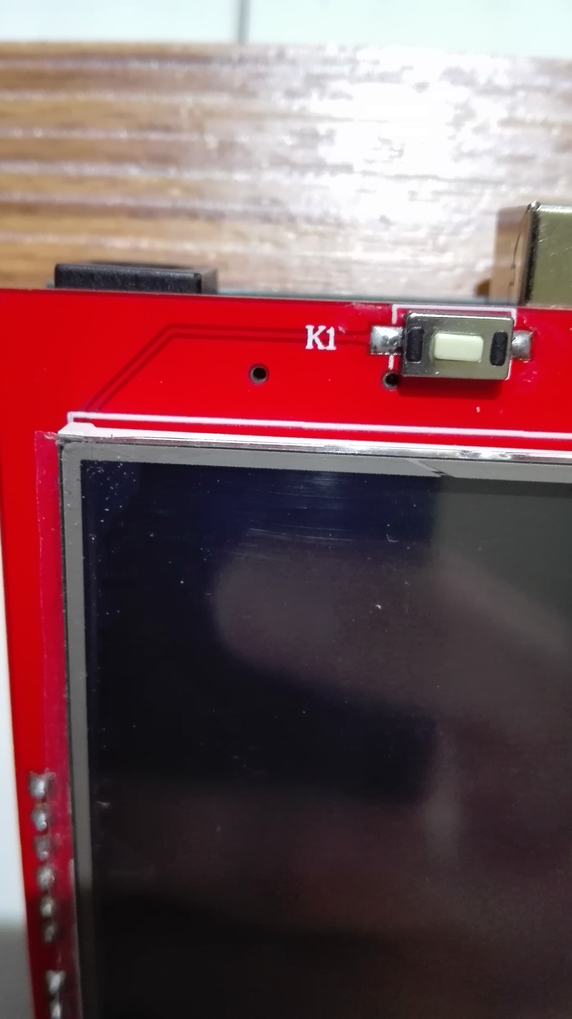

Look at the front of your shield.
A Touch Panel has a gold stripe around the outside with four gold strips at the bottom right of the screen.
A 4 way ribbon joins the gold strips.
Compare your shield with photos of genuine Touch Shields.
Or post a photo.
David,
okay !
i check the lines aroud the lcd at the middle-top of the screen has a space(like 45 degree cut) and also there is a space at the bottom of lcd. is this cutting or space okay?
4 pin connector seems to be okay and firmly connected to pcd !
now im sending some photo !!!
tnks !
Your photo shows the top of the screen. Any Touch Panel electrodes will be at the bottom of the screen.
Yes, it "looks" like the top of a Touch Panel. It also looks as if the electrode has a diagonal cut near the pushbutton K1.
Please post a photo of the whole screen.

You definitely have a Touch Panel. Ribbon at bottom left. Icons are a pretty big clue !!!
I have always assumed that the printed gold electrodes will be on the underside of the glass.
Is your diagonal cut on the surface of the glass?
You have a second diagonal cut near the "Home" icon. The Touch Panel was deliberately damaged.
If your Shield was advertised as a "Touch" display, ask the shop for your money back.
The Touch does not work.
David.

in this picture there is space aroud the lcd:

finally problem finds !!!
the 4-wire touch connector is not connected good to PCB !
when i pess and hold the connector the touch program running ...
but says "unusual calibration range"

is it possible to resolder this 4-wire pins? it likes plastic cable !
I had a close look at a regular 2.4 inch shield.
Sure enough, it has diagonal cuts in the printed gold electrodes.
I have never noticed this before !!!
So your shield might be rescued.
If you are confident with soldering SMT components, you can attempt to re-solder the 4-way ribbon at the pcb end. I don't think that it is possible to rescue the printed electrode connections where the ribbon joins.
Your calibration is rubbish. Run the calibration sketch again (when you have rescued the Touch ribbon)

yes, i have a doubt about these cuts on LCD but today buying new one !
and i see all of the 2.4" lcds have two diagonal space(cut) on it
