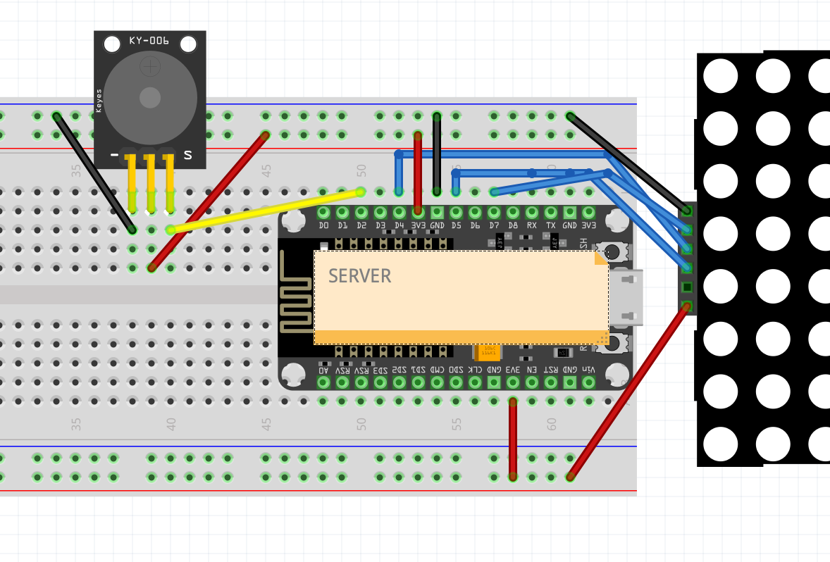

I have 2 ESP8266 one is the client and one is the server. Both are connected to the home wifi.
For the client i have connected 4 button (all to 3v and D2-3-4-5).
For the server i have a buzzer and a MAX7219 where i want to display the message.
The project will work like this:
If i press the first button, the client will send a message to the server and the server will buzz and put a message on the display.
But for now... the connection works but if i press the button nothing appears...

HOW are the buttons connected ?
It's connected like this:
A B
C D
A to 3V
B to D2 pin
D to GND
I just saw that i've made a mistake, the code for the server is client and client server...
This evening i'll modify in this way:
The server have the control on the led panel and the buzzer.
The client will have the 4 button.
The Wonders of Fritzing (always horrible).
A NodeMCU can't be placed on a breadboard that way.
And the pushbutton scheme is Wrong - it shorts 3V to GND.
(But maybe you're happy with that.)
I know it can't be placed like this, because isn't placed in the breadboard in the physical project. I put it close for the screenshot.
Nobody can tell what you are doing if you are not accurately presenting what you are doing.
The pushbutton is, still, a disaster (as shown).
I'm here to learn, i'm not a programmer :grimacing:
I think this is the correct way for the pushbutton, right?

Thanks you for your patience and for your help. Now i made a new scheme with how i connected the cables and the other things. I updated the code in the first post.
The server have the rgb 8x8 4 panel and the buzzer. (in the image it's in the breadboard but not physically)
I tried the panel and worked in a simple print project..
I put a buzzer in the server if (request == "bianco") but nothing happen...
I connected correctly this time.. (i think and hope), i tried it with a simple buzzer test code and it worked. Now for the project it's like this.
But now i'm stuck after the connection to the home wifi. They bot connect but if i press the button nothing happen in the monitor. For testing purpose it's only one button for now, the ButtonBianco.

This is how these type of buttons are connected internally
grafik
This means if you connect them the wrong way the connection between both ends is permanently given. => pressing the button does not change the IO-pin-state
Connecting +3.3V and GND permamently may have lead to that you have destroyed the voltage-regulator through the shortcut.
the microcontroller-world is not superstandardised like USB-devices
You have to take care of more things than just
"does the plug fit into the socket?"
best regards Stefan
