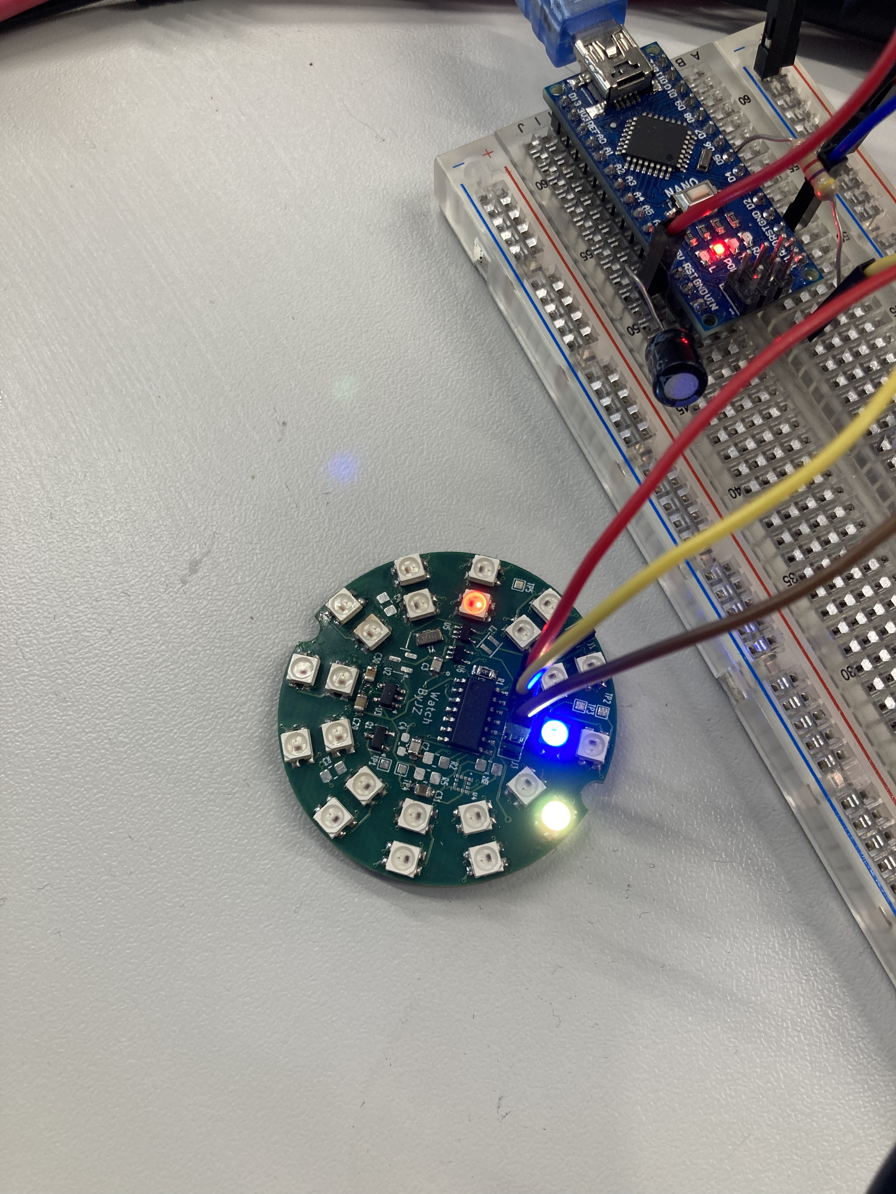

I'm making this WS2812B watch as a project for school, I'm using the attiny414 in combination with the tinyNeoPixel library. Everything is working fine hardware-wise so I'm able to make a LED-chase following the RTC using an external oscillator. The problem arises when I try to use my second data line to blink the other 12 LEDS. Then I just get 2 solid LED's on, and the first chase working. The chase works on both lines by the way, just not at the same time...
This is the code I have

And a picture of my watch. any help is much appreciated!
First observation, if you set teller = -1, then subsequently use it as an index to an array which you write anything to, where did that data get written???
According to what @camsysca wrote, you must not use teller = -1 as an array index
Look ar the code:
Why the separate case for clearing the 11th element?
Is it because you need to reset the teller after end of array?
Do it an easy way:
  strip1.setPixelColor(teller, 0, 0, 0);
  strip2.setPixelColor(teller, 0, 0, 0);
  ledStates[teller] = false;
  teller++;
  if (teller > 11) { teller =0;}
Why use two data lines? Tie DOUT of one to DIN of the other, use one data line, and treat all the pixels as one array. You only need some "mod 12" work and your sketch is simplified.
