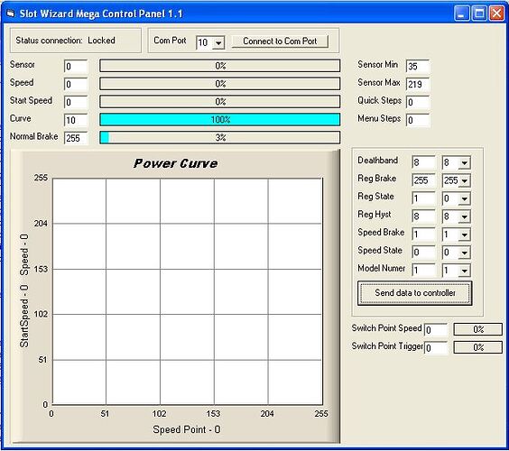

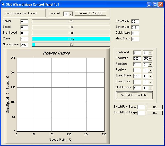

Knipsel2.jpg shows the two collums with on the left hand side the text boxes that read the data from the variabels from the Arduino. The right hand side collum has the combo boxes with the new values that need to be send to the Arduino and again need to be returned into the text boxes of the VB APP. This picture shows the data before the button is pressed and EEPROM data. Knipsel.jpg is the after the button is pressed once and the EEPROm data is overwritten.
Knipsel2.JPG|679x600
Knipsel.JPG|680x602

I changed to for(int i=0; i < fieldIndex; i++)
Now I see what you tried to tell. But same problem still.
Paco
