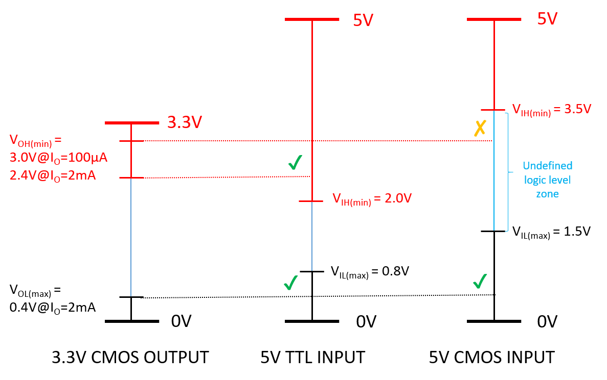

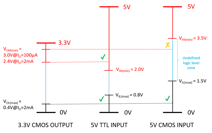

There can be a timing issue with the LiquidCrystal library when trying to use 3v Arduino boards with a 5v LCD.
When using the 3v modules like the ESP32 and the esp8266 there can be and often is a timing issue on the E signal transitions due to the slew rate of the rising E signal.
It is subtle but here is what is happening.
Since the 3V voltage is right on the edge of working with the 5V LCD, to ensure that the signals are high enough voltage for the LCD, the code must wait just a tiny bit more to allow the signals to fully rise all the way up to the full 3V voltage.
If you don't do this, communication with the LCD can be unreliable.
How bad this is, or whether it shows up depends on the board, the supply voltages, and the wiring used to connect between the board and the LCD.
The hd44780 library has code to work around all this so it should not be an issue.

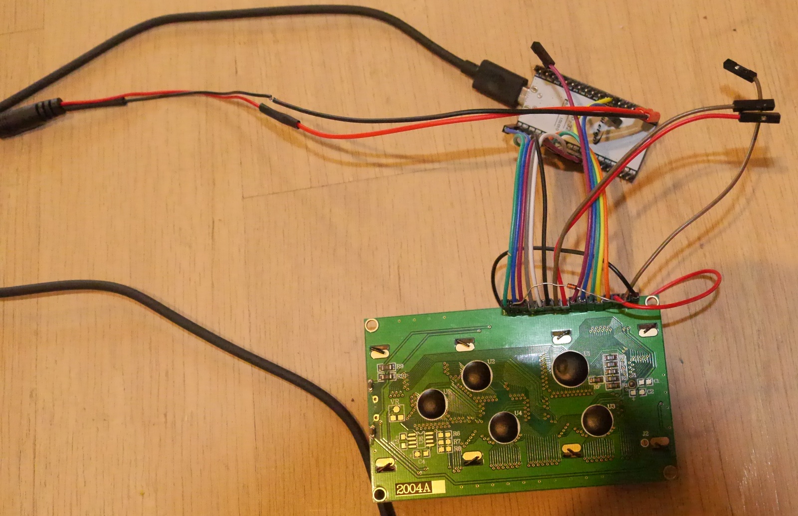

Please post some photos of your setup.
Post some photos so we can see how you have everything wired up.
The photos need to be good enough and clear enough so that we can see everything well enough to replicate your setup.
and also a photo of your soldering on the LCD so we can also take a look at soldering for the wires and/or header attached to the LCD.

I bought this three years ago. No more aliexpress link. Looks pretty much like a typical 20x4 module, e.g., Lcd Board 2004 20*4 Lcd 20x4 5v Green Screen Lcd2004 Display Lcd Module Lcd 2004 - Lcd Modules - AliExpress
It would be hard to photograph it in such a way that one can tell what wire goes where: it's too much of a mess of wires hanging in the air, as I am connecting the LCD via Dupont connectors to the ESP32.

arpruss:
A "mess of wires" may very likely be your issue as poor wiring can cause all sorts of weird issues.
Wiring issues is the #1 cause of LCD issues. Either incorrect wiring, issues with soldering, or issues with the connections either inside the actual wire or where the wires connect to something.
There can also be issues when wires are a bit long or from getting cross talk between them.
There are also several kind of issues that can come up when breadboards are used.
This is why we need to see actual photos of what you are using.
I'll wait for photos that provide the information that David and I asked for before any further comments.
See post #29 for summary of what we are wanting.

  • When I put a diode between the ESP32 5V pin and the LCD VCC pin, everything works great in 2-line mode with both libraries: 4 lines of display, good contrast (with contrast pin grounded), complete success.
Here's my guess as to why the diode makes a difference. The ESP32 5V pin normally was supplying about 4.6V to the LCD. I am guessing that the data levels of the HD44780 are pegged to the supply voltage, and the 3.3V data from the ESP32 was insufficient to control the HD44780. However, the diode dropped the supply voltage to 4.0V. With the supply voltage at 4.0V, the 3.3V data from the ESP32 was sufficient to control the LCD.
If I am right, then what I needed was a sweet spot in the LCD VCC. When the LCD VCC was too low (e.g., 3.3V) then I needed a negative voltage for correct contrast. When the LCD VCC was too high (e.g., 4.6V or higher) then I needed a data level higher than what the ESP32 produces. But there is a sweet spot in the supply voltage where the 3.3V data level is good enough and the contrast works without negative voltage.
And another bonus of the diode. Without the diode, serial uploads to the ESP32 would fail until I unplugged the LCD from 5V (they worked fine with the LCD at 3.3V). But with the diode in place, serial uploads work fine.
So it's looking like this is a complete solution, though it is rather hackish. Do my speculations sound reasonable? I am much more of a software than a hardware guy.
And here's a picture of the horrible looking prototype. You can see the diode pressure fitted into the backs of two Duponts. :slight_smile:
The barrel plug (on the left, partly out of frame) is to connect to our exercise bike's rotation sensor. The project is a Bluetooth adapter for our exercise bike so it can be used with Zwift or RGT Cycling, but as a bonus I am adding a display with better data than the bike's built-in computer has. (The really hard part of the project is the physics calculations to get the wattage from the resistance setting and the rotation speed, since of course the bike manufacturer has not published speed / power curves. I've been figuring out the resistance quantities by attaching a known weight to the pedals and measuring drop times.)

here is some additional information about using 3v outputs with 5v inputs that you might find useful.
--- bill
bperrybap:
How to interface a 3.3V output to a 5V input. – next-hack.com
Is the HD44780 a CMOS or a TTL part? The link you give says that for 5V CMOS, things are undefined for inputs between 1.5V to 3.5V. And the 3.5V precisely matches the data sheet's 0.7*VCC figure.
I, too, have never had trouble before with a 5V part registering 3V inputs. But it's hard to see why else dropping the supply voltage makes the LCD work great.
