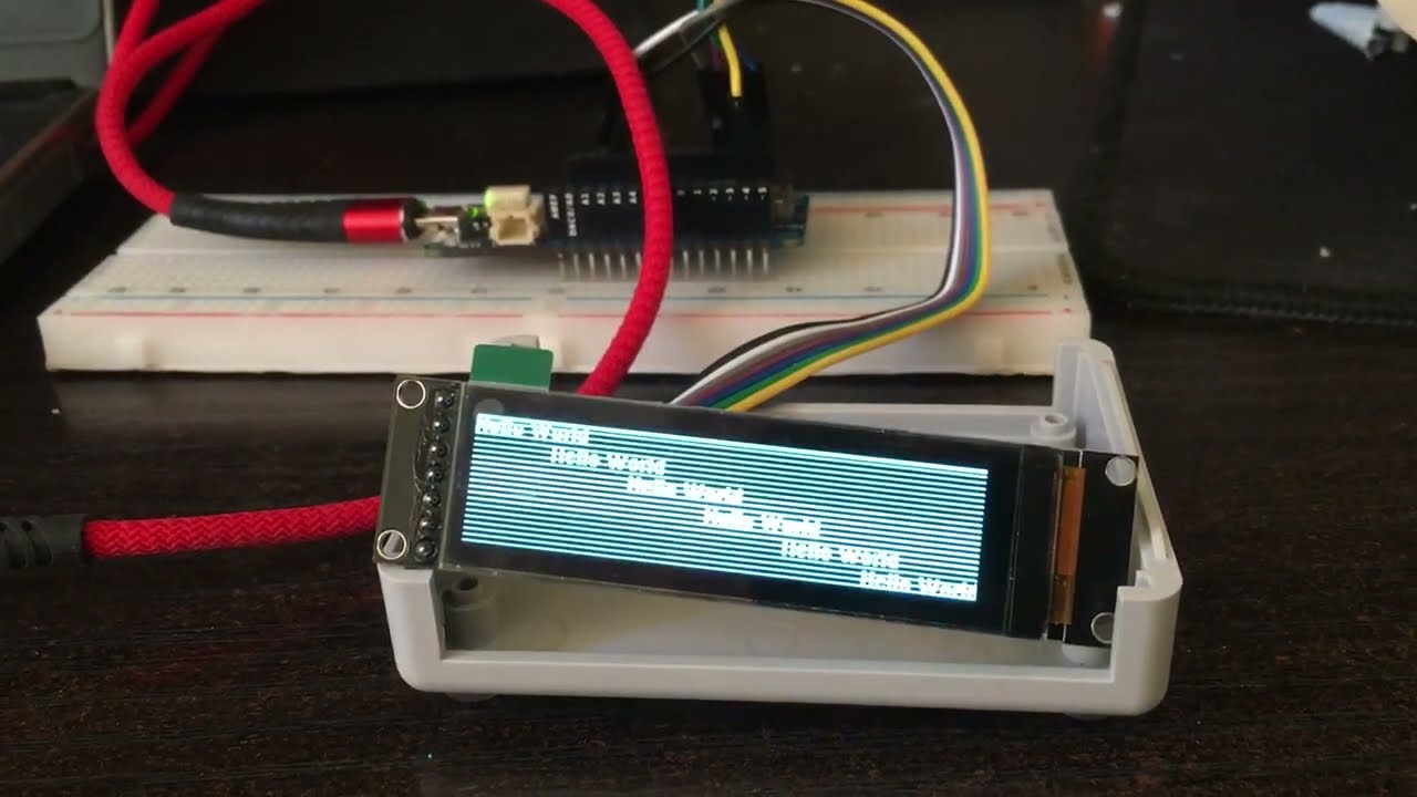

256x64 SH1122 7pin SPI OLED example for MKR boards [code example]
This is an example connection and code for Arduino MKR boards
  • Install U8g2 library
  • If sketch wont compile because of <Wire.h> is missing, add it then remove include later. It is not needed but takes some space.
  • At max brightness it consumes ~60mA
#include <Arduino.h>
#include <SPI.h>
#include <U8g2lib.h>
SH1122 7pin SPI 256x64 OLED example
by Killzone_Kid
Display		|		Arduino MKR Board
	GND		|		GND
	VCC		|		VCC (3.3V)
	SCL		|		SCK (Pin 9)
	SDA		|		MOSI (Pin 8)
	RST		|		Pin 6
	DC		|		Pin 7
	CS		|		Pin 4 (PIN_SPI_SS)
#define PIN_DC 7
#define PIN_RST 6
U8G2_SH1122_256X64_F_4W_HW_SPI u8g2(U8G2_R0, PIN_SPI_SS, PIN_DC, PIN_RST);
	u8g2.begin();
	u8g2.clearBuffer();
	u8g2.setFont(u8g2_font_helvB08_tr);
	u8g2.drawStr(0, 9, "Hello World");
	u8g2.drawStr(40, 20, "Hello World");
	u8g2.drawStr(80, 31, "Hello World");
	u8g2.drawStr(120, 42, "Hello World");
	u8g2.drawStr(160, 53, "Hello World");
	u8g2.drawStr(200, 64, "Hello World");
	u8g2.sendBuffer();
	for (int i = 0; i < 3; ++i)
		for (int j = i; j < 64; j += 3)
			u8g2.drawHLine(0, j, 256);
			u8g2.sendBuffer();
			delay(10);
NOTABLE PROBLEMS WITH THIS DISPLAY:
It doesnt handle full screen fill well
It makes noise
